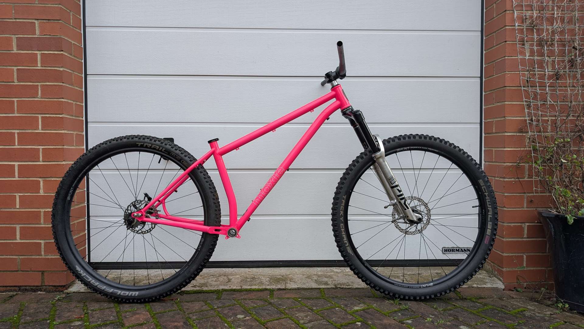

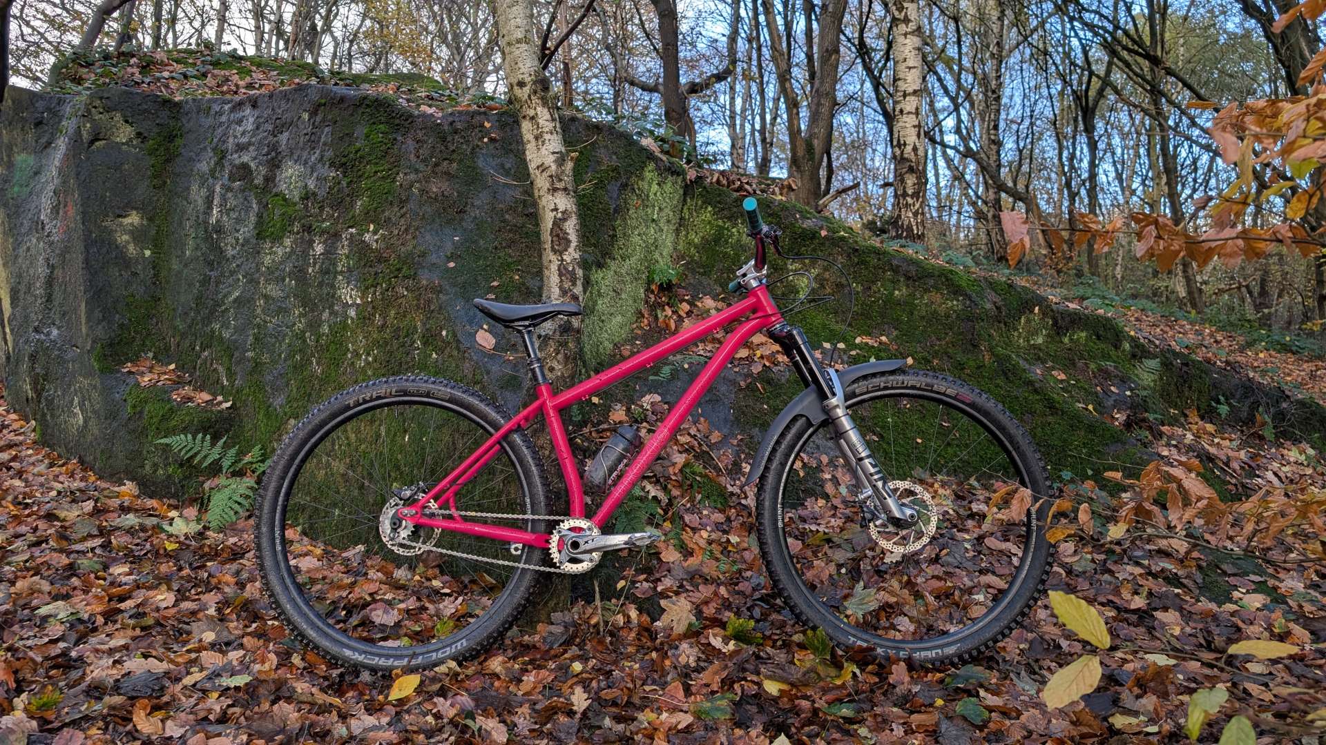

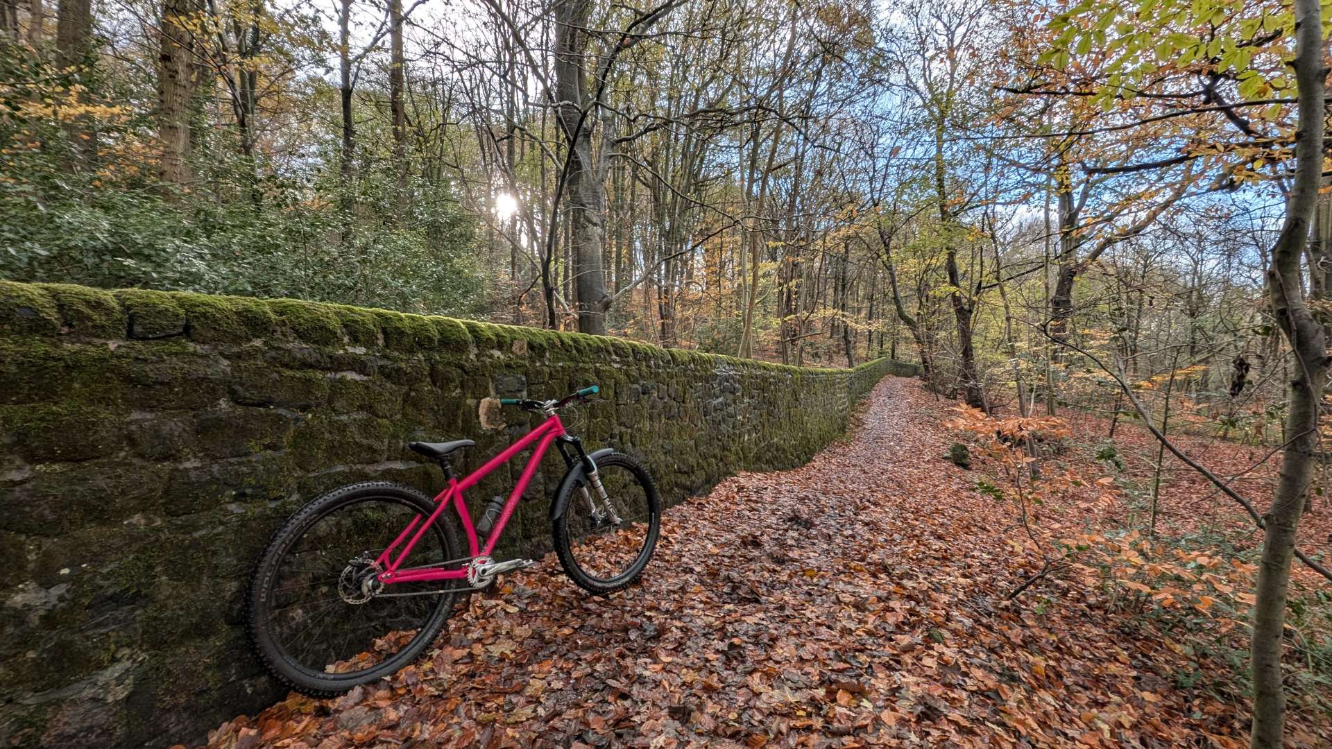

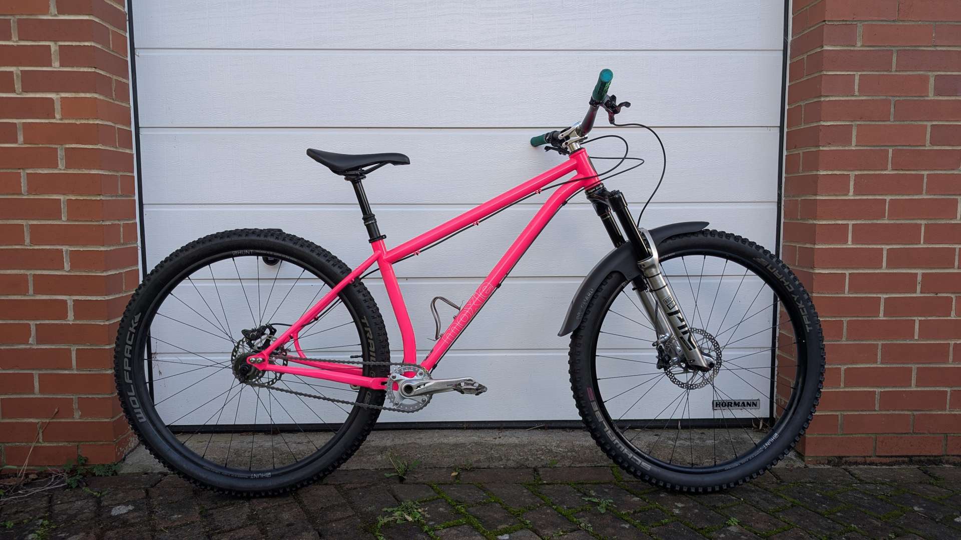

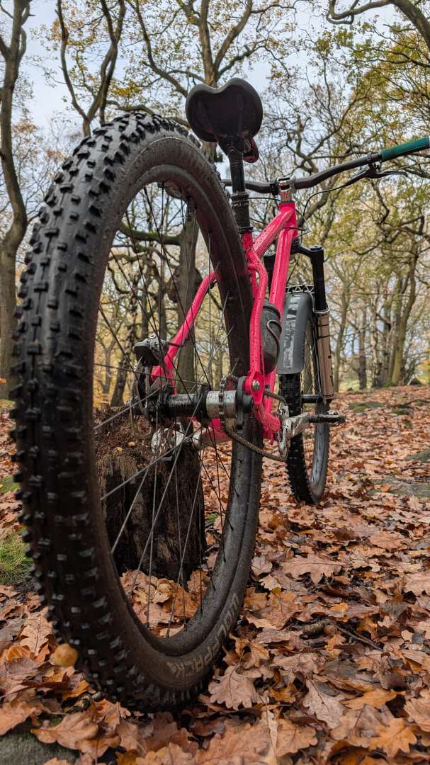

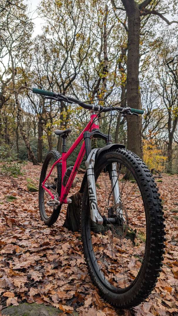

First ride out yesterday on my new(ly built) Singlespeed Hardtail.

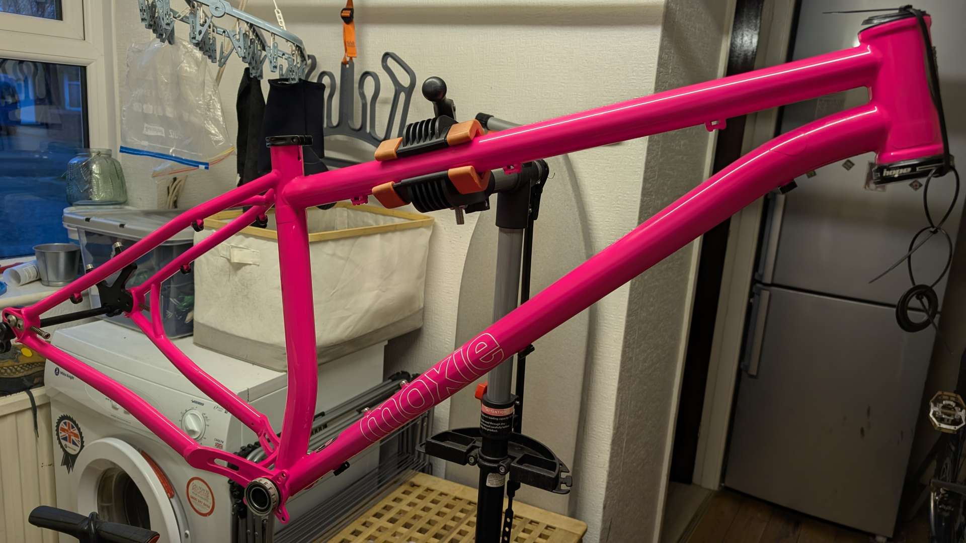

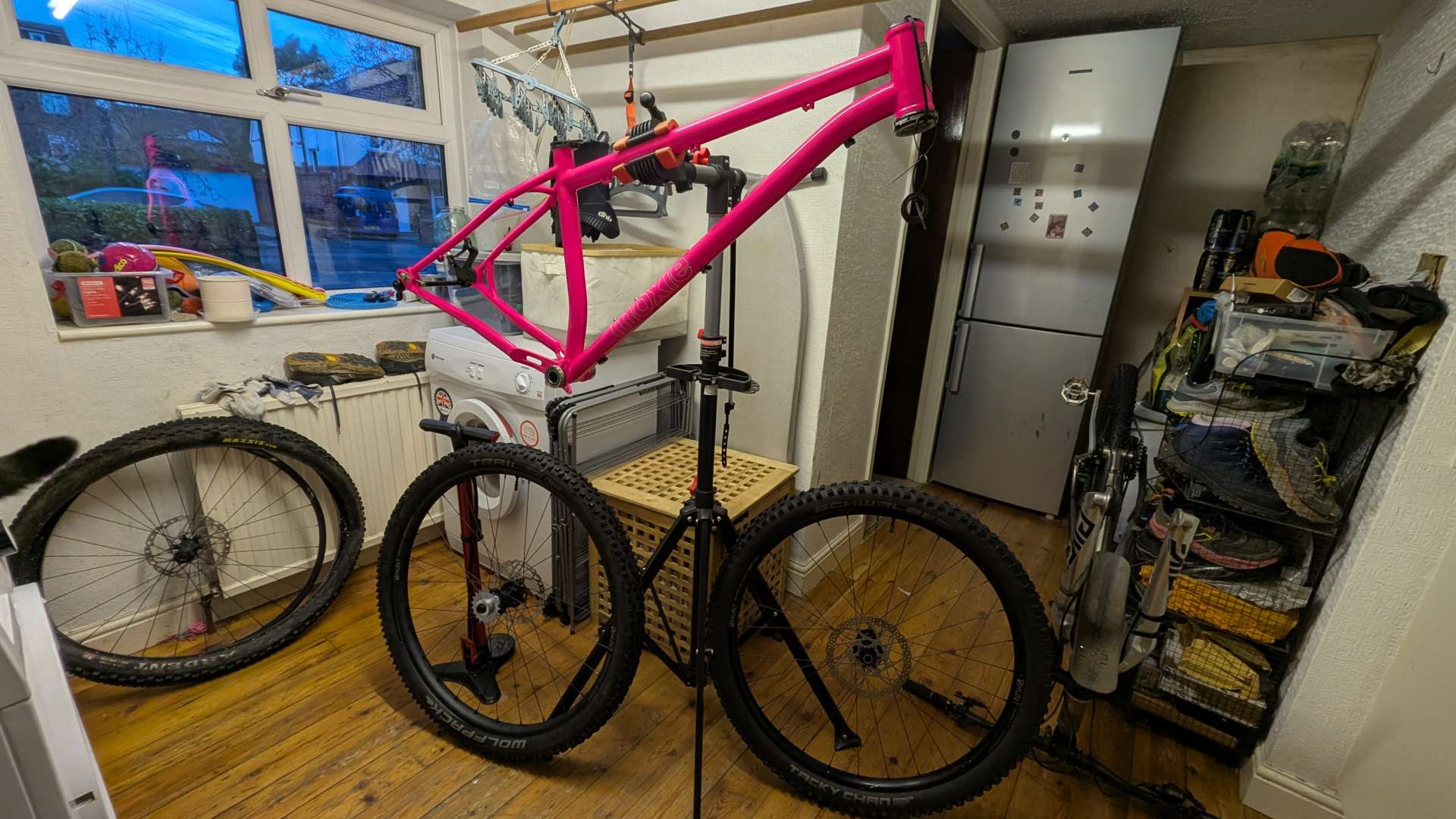

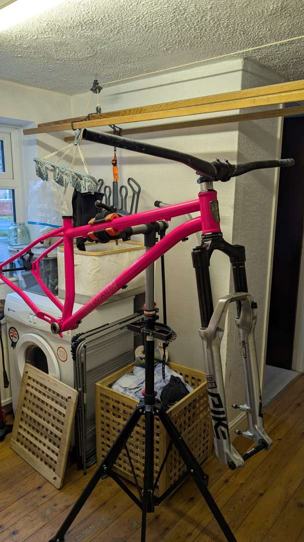

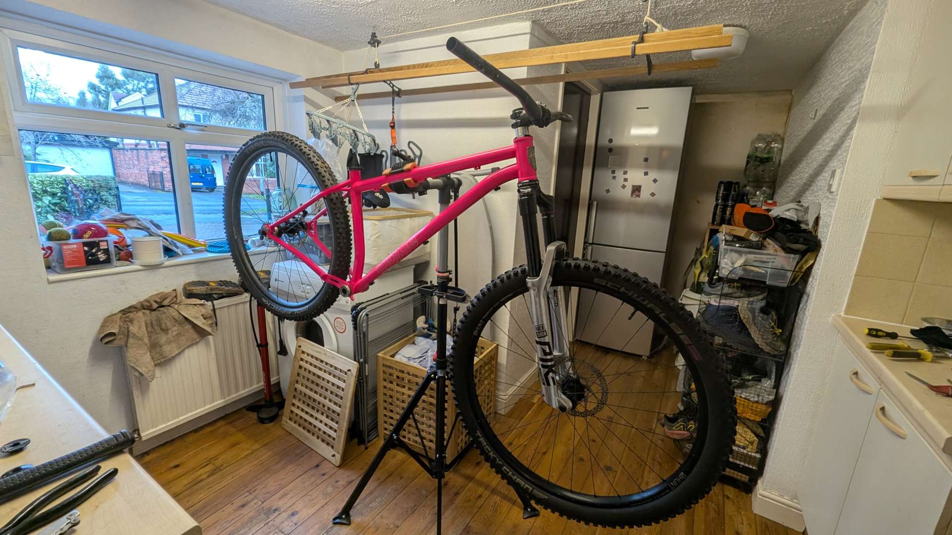

Picked up a lovely condition, lightly used Pipedream Moxie MX3 a couple of weeks ago, and have been collecting bits & pieces for it, finally putting it together over the weekend.
I've ridden SS for years, most recently on a 2017 Ragley BigWig with a BB mounted chain tensioner. But really wanted a dedicated SS frame, and had most of the key parts, so found this ace Moxie. I'd also been considering the Kinesis FF29, but no one seems to have one so it was difficult getting any real world reviews, and besides, it was more expensive and without BB, headset or brakes (all of which came with the Moxie).
Build progress ...
PXL_20251121_160823706.jpgPXL_20251121_160840046.jpgPXL_20251122_085402464.jpgPXL_20251122_091503258.jpgPXL_20251122_092903872.jpg
Ready to ride ...
Out on the trails ...
PXL_20251123_110438842.jpgPXL_20251123_111125295.jpgPXL_20251123_111140411.PORTRAIT.jpgPXL_20251123_111817370.jpgPXL_20251123_111830444.jpg
Some close-up details ...
PXL_20251123_110504031.PORTRAIT.jpgPXL_20251123_110529117.PORTRAIT.jpgPXL_20251123_110548100.PORTRAIT.jpgPXL_20251123_114852416.PORTRAIT.ORIGINAL.jpg

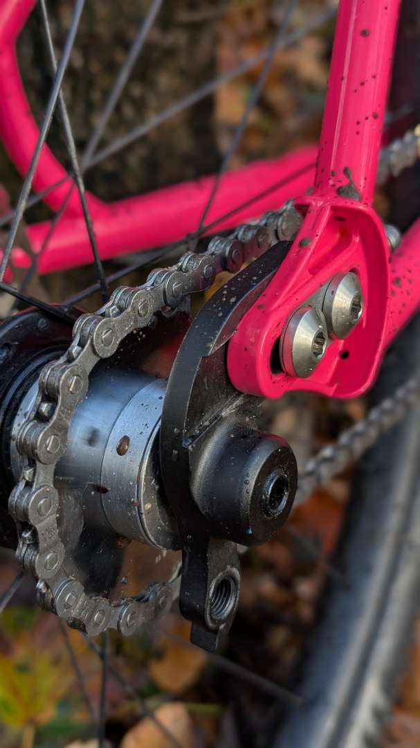

Sadly, yesterday evening, after trying to loosen off the bolts holding in the SS dropouts, I rounded the hex head of one of them, and it's still stuck firm. I don't have the tools, skills or bravery to attempt anything further myself, so will be popping it down to the LBS today to see what they can do ...

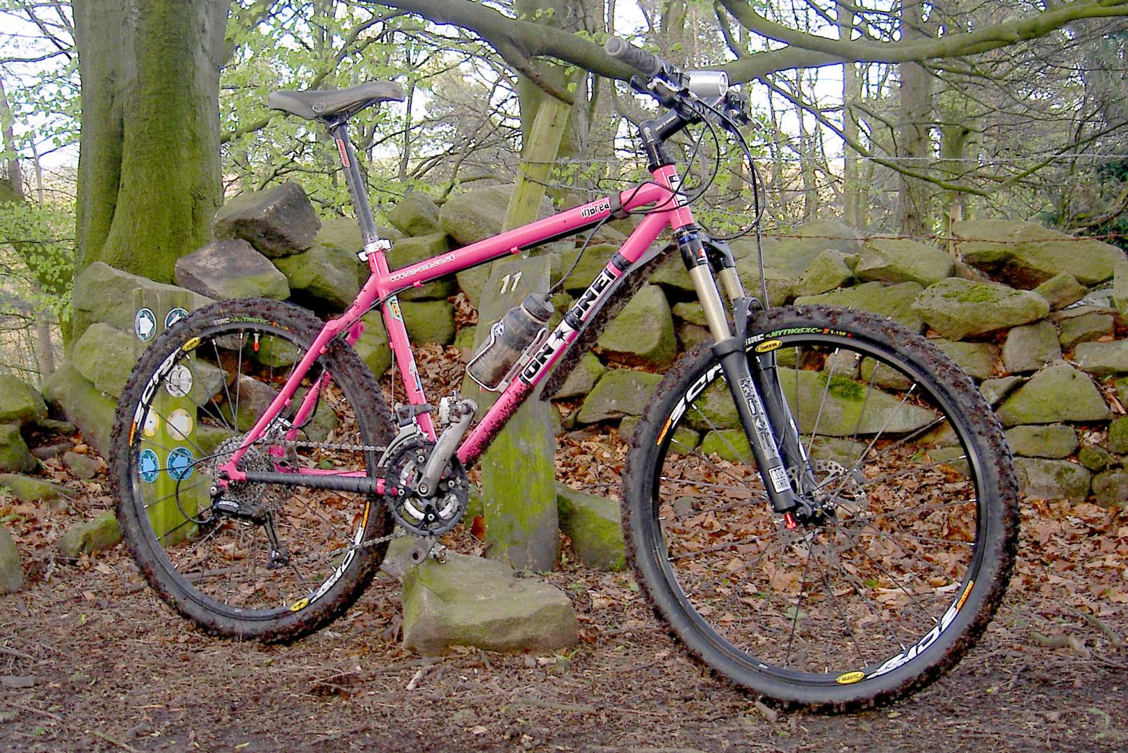

Should be more pink bikes - this was mine back in the olden days!... 🤣
The low profile heads look nice but won't tolerate much torque I'd imagine.  Better to replace with something decent if you occasionally suffer from the fists of ham.
Yup. Definitely ham-fisted on my part, and failure to check/prepare ... I was so keen to get the build finished and get out riding that I didn't check/grease the dropout bolts!

ProBolt- in the flavour of your choosing. That's the "bicycle" range but they do all sorts and they're very nicely made, if a bit pricey.
Could swap those for a button head but may be similarly shallow or a tapered cap head.  Do you know what the bolt size is? Diameter/length/head diameter/head depth? how deep is the hex?
A Ti Flanged Hex would be the ultimate in rounding off avoidance. (Obviously size to suit)

Those dropout bolts are the one weak point - I bought some fancy Wera allen keys and a matching torque wrench which solved the rounding problem with cheaper allen keys. However I would like some better bolts, so let me know if you find some sturdier ones!
These are the ones on the Pipedream website: https://www.pipedreamcycles.com/shop/dropout-bolts/
Still got my pink 456 (although that looks like an 853 Inbred) and it's still not a bad bike it's just newer bikes are better.
