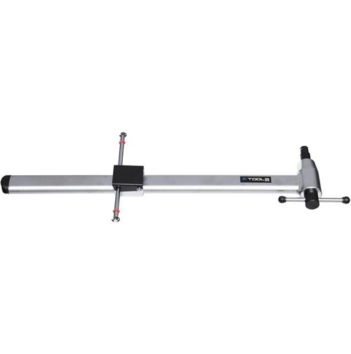

I've had some issues with a new build recently (whole different thread,  sunrace 11-50 related) and a few people said the derailleur might be out.
So bit the bullet and got this from CRC.
 Turns out the derailleur was out. Don't know if it will sort the indexing issue I have but it can't do any harm.
Yes,I did check by moving the valve point around the wheel with the tool to exclude wheel wobble from the equation.... I almost didn't though. Top tip there. 😉
Will be checking the other 2 bikes now! Never, ever used or had this tool till today.
One of those tools you won't use often but when you need it...... 👍

OP, I think the "wheel wobble" would have to be pretty bad to make a massive difference over that ratio. Worth being aware of, yeah, but not a massive concern.

I can't work out how that tool fits - anyone enlighten me?
Posted : 06/03/2018 11:48 am
Posts: 16684
It address into the mech hanger mate.
It just checks the mech hanger is parallel to the wheel at it's fundamental simplest. Some vids on YouTube no doubt.
Posted : 06/03/2018 12:04 pm
Posts: 10341
Ta - just wondering if I can 3D print something that would do the same job. I reckon I could with an M10x1mm pitch bolt (not cheap to be honest).
Posted : 06/03/2018 12:21 pm
I can’t work out how that tool fits – anyone enlighten me
You remove the rear mech and screw it in its place. (that's the bit at the RHS of the photo) You then slide the bit on the left to align with the rim, the little rod at right angles is then adjusted to just touch the rim. You then swing the whole assembly to several positions, the little rod should stay the same distance from the rim at all points. Because the mount point isn't central to the wheel you have to slide the rod in and out along the main shaft.
If the  hanger isn't straight you use the main bar as a lever to ease it back. A bit primitive but it works.

Ta – just wondering if I can 3D print something that would do the same job. I reckon I could with an M10x1mm pitch bolt (not cheap to be honest).
You'll need something stronger than plastic. You could 3D print the gauge part but the bar and attachment to the hanger need to be metal.
Posted : 06/03/2018 1:22 pm
Posts: 10341
You’ll need something stronger than plastic. You could 3D print the gauge part but the bar and attachment to the hanger need to be metal.
Yep, I didn't realise until after I posted that the tool is also used to straighten the mech hanger.

AlexSimon
The point of the tool is that it is robust enough to bend a hanger straight into alignment.

One thing I've wondered with these - I'm assuming they rely on the wheel rim (that's being used) also being true? Or if it's not (true), do you just use another section of the rim?
Posted : 07/03/2018 10:51 pm
 JoeG
One thing I’ve wondered with these – I’m assuming they rely on the wheel rim (that’s being used) also being true? Or if it’s not (true), do you just use another section of the rim?
If the wheel isn't true, just turn the wheel so that you are always measuring against the same spot on the rim (i.e. the valve stem).

Posts: 16684
What joe says, I use the valve as the reference for obvious reasons. 😏

Be gentle if you feel the need to realign. That tool can tear a mech hanger when you apply the pressure. Not all hangers are made of cheese, but the one on my Boardman frame was! Replaced with something much more robust.
I find shifting woes are more commonly due to cable friction, usually in the last loop, and the rear mech can tolerate a reasonable amount of wonkiness, certainly more than can be detected by eye. One up and two down or vice versa is always cables. Often at the cable ferules, which develop tiny kinks.

I am with TiRed here, I am perhaps even more skeptical than him. This feels like a tool to solve a problem that does not exist. I have bent a few hangers, all bent back by eye and pliers, and never had shifting problems that were not solved by adjustment and well maintained cables. I am convinced that no two hangers are at the same angle on any bike, due to manufacturing tolerances etc. This is whey the derailleur is such a great piece of kit. If you don't believe me, just wiggle any mech from side to side and you will find more movement than any undetectable by eye misalignment anyway.
A buddy uses one of these, but every time he has "fixed" a problem hanger, he has also renewed cables. I know what I think the fix is.
Posted : 08/03/2018 12:21 pm
The instructions that come with the tool mention that once within a few mm variation around the rim you are within tolerance. It's much more about getting things within the right ball park before you start messing with cables, outers, etc.
In my case the hanger was out in two dimensions and the tool definitely helped in finding the fore-aft twist.

I bought the Lifeline one from WIggle a few years ago (£25 at the time). Reading the reviews, a few people mentioned undoing the grub screw, removing the central bolt that screws into the hanger and wrapping it twice with PTFE tape before reassembling. I followed these instructions when mine arrived and it cured the slight wobbble/play that was present. Getting the hanger 'hanging' correctly makes indexing the gears so much easier. If you know it's straight you can discount it from the equation. I've only used it three or four times but it's saved me hours of grief. I was trying to index a new derailleur for hours before buying one and couldn't get it to work, I eventually discovered that the hanger was about 5mm out. Straightened the hanger, gears indexed in about 5 minutes.

BTW if you still have indexing problems after straightening a hanger, new cables etc and you have ruled out compatibility issues, It's most likely a bent mech cage or mech linkage! Sometimes you can bend them back, but it's surprisingly difficult by eye and a bit hit and miss. I've even hammered both plates flat on a bench and it's still not quite right until I put a new mech on!
