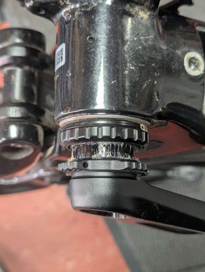

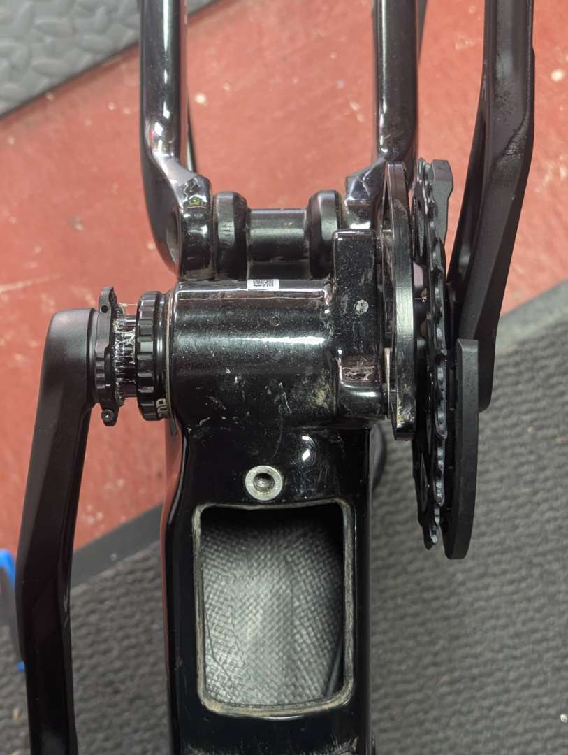

Why does this crank axle look freakishly long?
PXL_20250922_124149072.jpgoriginal_32b677b4-5bce-46cd-a4ae-0fe462f106af_PXL_20250922_124211809.jpg
There's about a 10mm gap with the bolt nipped up. What am I missing?
I already have a Dub BB. I've removed a GX crankset. I haven't dropped or misplaced any spacers and there's nothing left in the box. It should be a straight swap surely?

That'll be a dub wide crank. Just needs a 3mm non driveside spacer / 5mm driveside IIRC. Just fitted one on my son's bike #standards!
(Should say Dub wide or wide on the axle)
Here's the SRAM doc to find you spacer config -

You have yourself a dub wide crank, it will need spacers

Oh my God I'm reading about it now and they have actually invented a new axle length BB combo and called it 'wide'. The absolute MF'ers.
So I need a new Dub Wide bottom bracket, or the spacers? If I can find a BB in the LBS I'll buy it because this one if a few years old now anyway.

Dub and Dub Wide BB are exactly the same in terms of the cups and bearings they just come with a different set of spacers. You can also buy the spacers seperately.
(Its the crank and axle that are different, to get the big wide chainline we need).
See this document here to workout what combo you need:

Saved by Halfords.
I just found some Dub BB's reduced to £23 that come with a selection of spacers so now I'm in business. BB has gone into the spares bin for the future.
Once it was bolted on it took seconds to set up. I didn't have to cut the chain so I stuck the hole thing on, paired the shifter and mech and it started working perfectly right away.

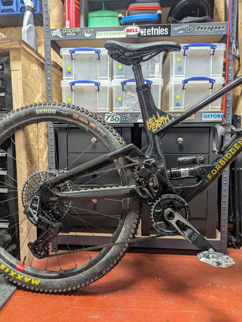

Did a few miles today on the new robo-gears.
It's bloody good innit!
I'm yet to test it properly off road, I'll do that next week. Happy with it so far. We'll see what it's like when it's covered in shite.
