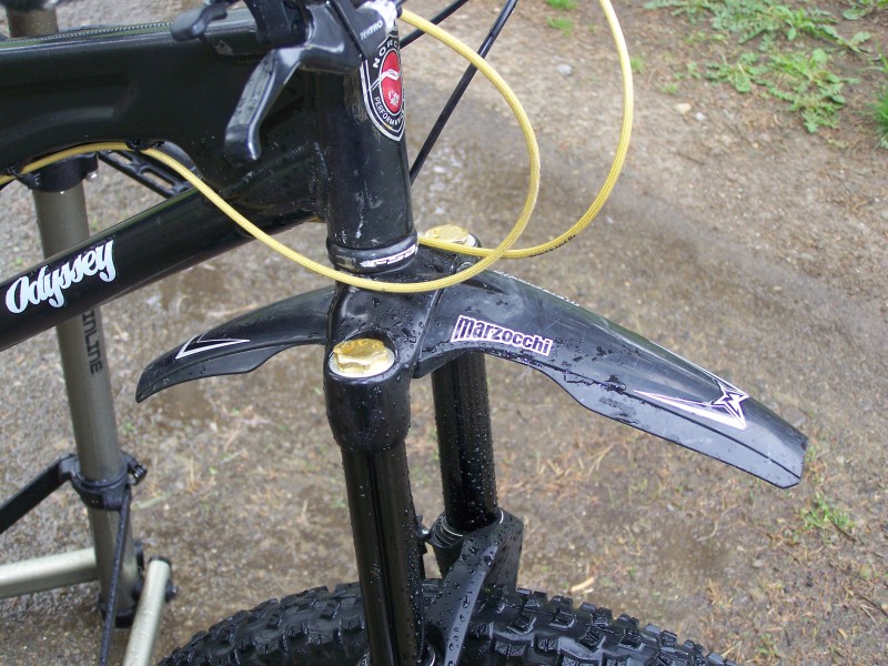

I have a love/hate relationship with the fork itself, but this thing is bloody brilliant. If only other manufacturers had cottoned on:
