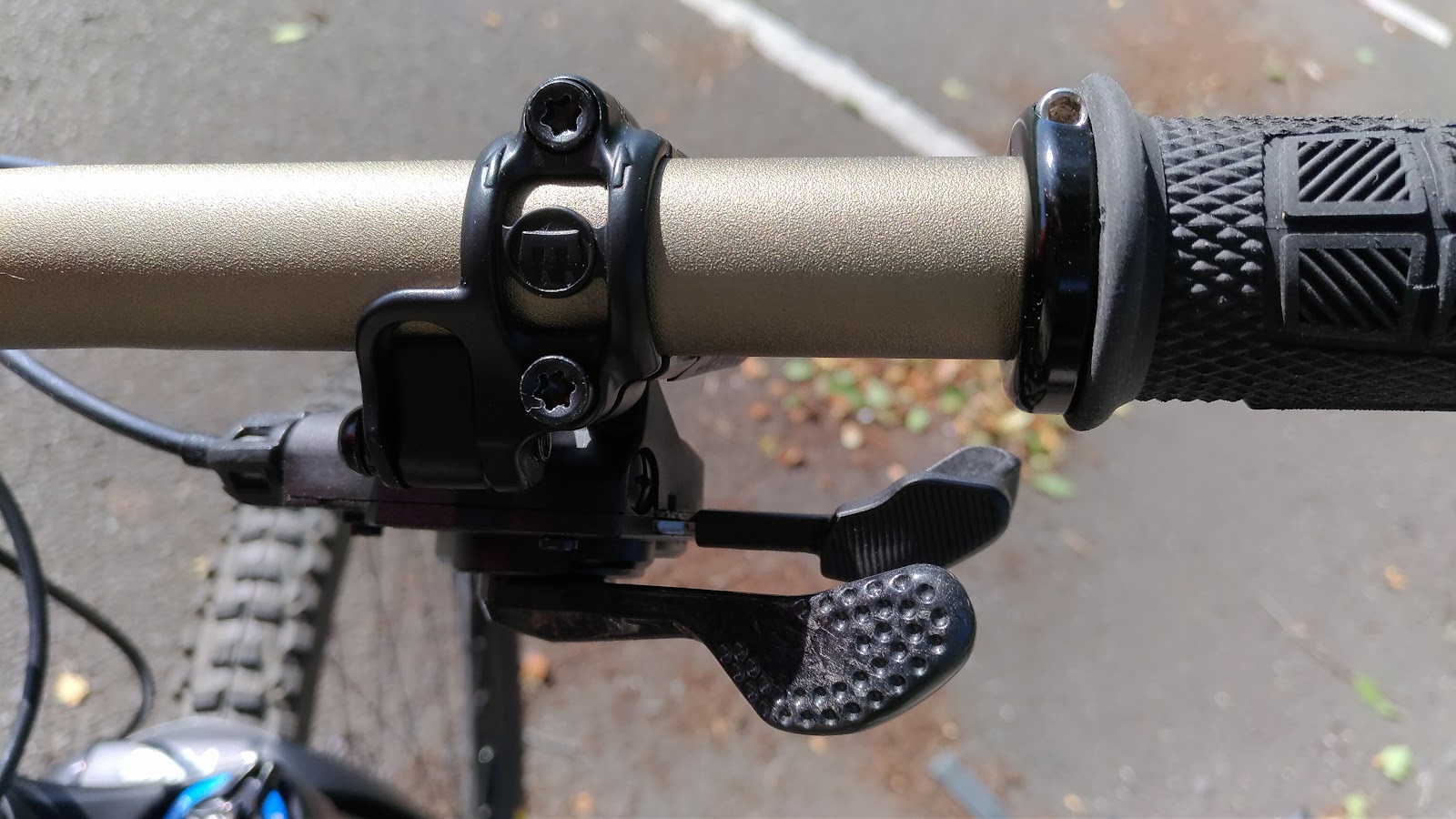

I'm guessing it fits something like the image below, looks like it should work fine
Posted : 25/01/2018 5:33 pm
Posts: 10520
Yeah, on that pic the adaptor holds the shifter in board of the brake, but I found I couldn't reach the levers as I like my finger right in the hook of the brake level. so I had to swap them round so the shifter was closer to the grips. Fine if you have both sides but if you're only using one as most will nowadays, it could be a bit dodgy. Or I'm just a freak!!
