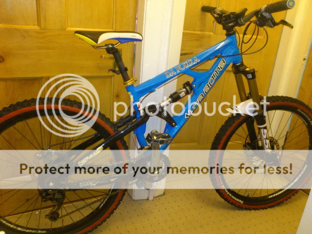

sorry guys but the images above were for illustration purposes only...i dont own those bikes...
the shock in question is a rock shox monarch rl and it going on the bike below...
i've fitted the shock to the bike but at the moment the shock face the same direction as the shock on the red and black frame...just wanted to know is this the wrong way around or would it be better to have it the other way round...

T'other way up but different shock ?[img] [/img]
Posted : 25/07/2013 11:34 am
The blue bike in your pic has the shaft at the front/top ..
Posted : 25/07/2013 11:35 am

If the spacing is the same you can just undo the shock bolts and turn it the other way round.
the spacing isnt the same on the frame...so i'll have to drift out the mounts from the shock eyelets and install them the other way around...i was hoping that i would be able to get away with it as it is...

after taking all opinions into consideration and having a long hard stare at the bike last night i decided it didnt look right so i did the switch...
