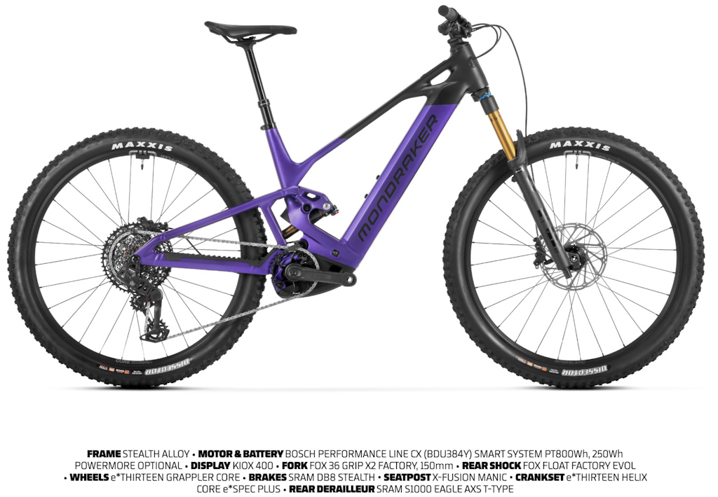

Mondraker launched this today interestingly...
Looks like a shorter travel version of my Crafty, a bit more emphasis on all day pedalling with the full fat CX and 800Wh battery too.
