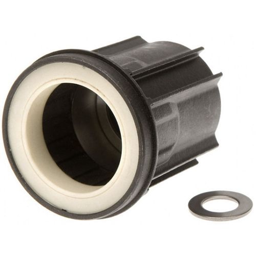

My Ksyrium freehub started making an awful noise late last year, I did some research and ended up using Shimano mineral brake fluid on the seal surface of the freehub. I've not had a problem since.

Same for me, probably not the best thing, but brake mineral oil worked for me. That was prob 4 years ago....

Shimano mineral oil in mine too.

I my case the horrible noise was coming from the freehub, when I stripped it, it was pretty clean inside and just a light smear of Shimano mineral brake fluid on the white bit in the photo was enough to cure the problem.
[img] http://media.chainreactioncycles.com/is/image/ChainReactionCycles/prod4855_NC_NE_01?wid=500&hei=505 [/img]
