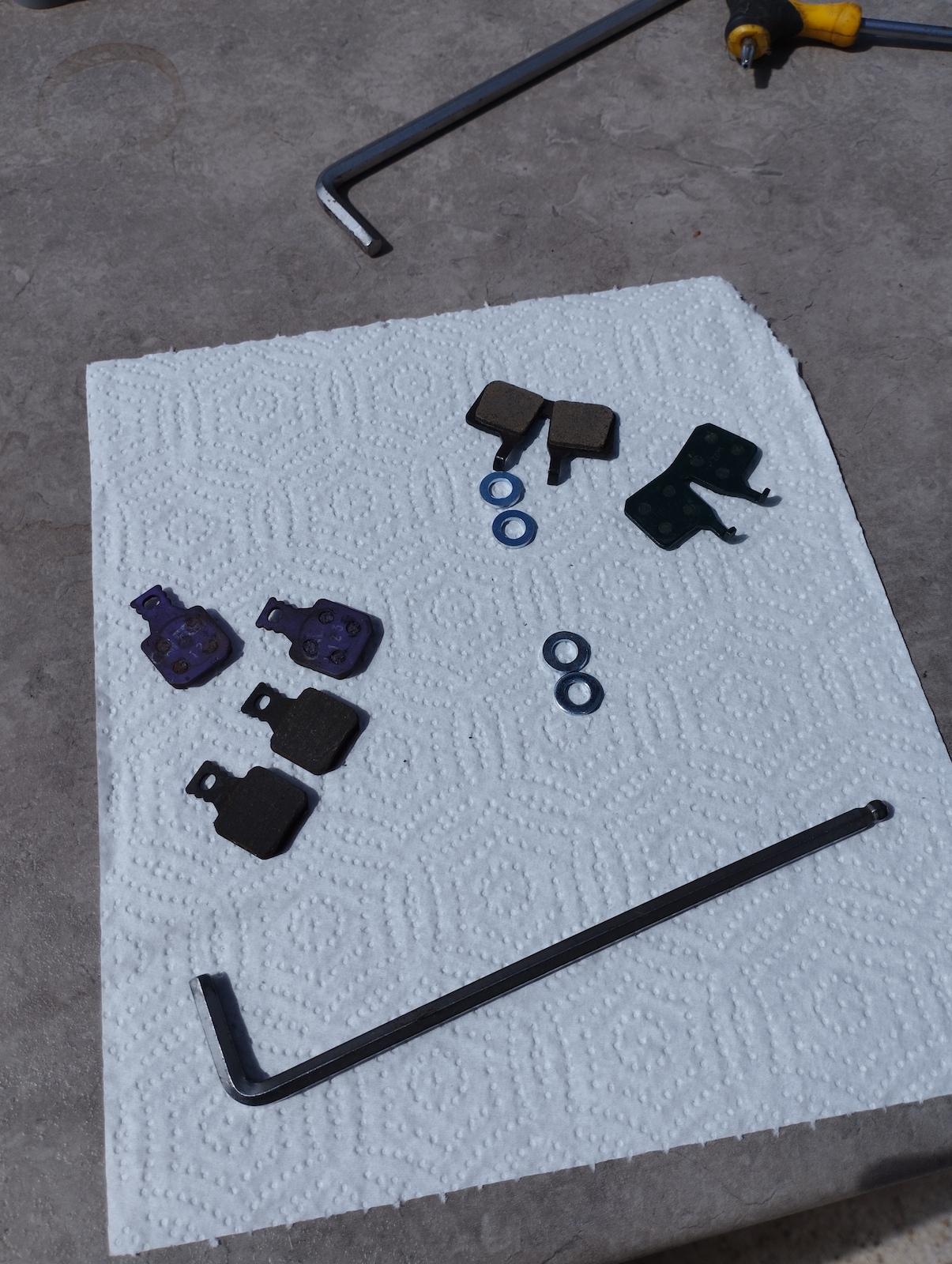

I've recently bought a lovely new bike,a Transition Spur. The bike is fantastic but it came with the Maguras but matched with TRP rotors but suffered from really bad brake noise-the classic avid brake turkey gobbler sound under braking. I thought that maybe there was a mismatch in resonance here between caliper and rotor so thought buying new Magura Storm rotors to have a 'matched system' would solve it-it hasn't ,if anything it's worse. Anyone have any experience with these brakes-that could offer me a solution.....Cheers.

Technically second hand,but barely ridden. Like I say brand new rotors now and bedded in properly but hopefully I  wouldn't need to sand down all pads  -  there 8 of them in total.
I'm wondering if it's the pad contact area-pads seem to brake lower on the splines of rotor /gapped bit .

Thanks for the suggestions folks,turns out the bike shop had by default swapped out the original brake pads for Galfa ones that they consider superior......they are a different design to originals being individual pads rather than connected ones and also being bolt in rather than free floating . Anyway just had a quick bedding in ride and the Spur and brakes are now  quiet.....as it should of been-hopefully it continues..... .

Where are those washers from...
Posted : 14/08/2023 1:39 pm
Posts: 8178
Official Magura pads can be linked (i.e. 1 pad per side) or separate (2 pads per side). The linked pads are normally the lower spec oem item. E.g. https://magura.com/en/EUR/product/brake-pads-sport/more . If you look at the 2nd and 3rd pictures both the separate and linked version are available. If you look at the higher spec pads (race version) there is no linked version available. The linked version does not require a retention pin which is a cost down on the cheaper brake models. The retention pin is an upgrade as it makes pad swapping easier and they are more secure.

Those washers were my plan B/fault finding  -just in case all  the noise was caused by the pads running too low on the rotors.....plan A seems to have worked  though (fingers crossed).
