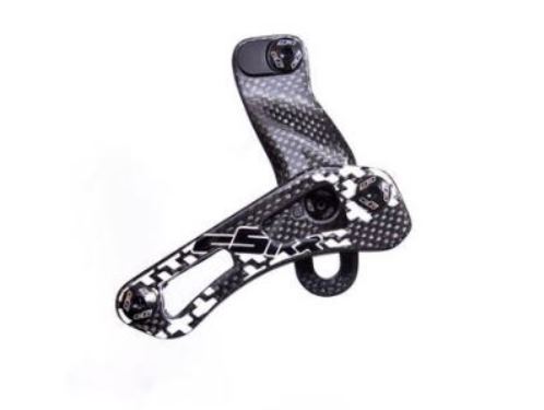

Posts: 55
It's not a weight issue. My front mech is direct mount and bottom bracket is pressfit, making it difficult to find a guide at all. I'm wondering if a wolftooth type chain ring may negate the need for a guide.

Posts: 55
The direct mount front mech means the seat tube is a funny shape so I can't attach a guide here. The pressfit bb means I can't attach a guide via the bottom bracket.

Get a direct mount guide, such as the CSixx
Easy to install, works well.

Posts: 55
The CSixx guide is £99! The cost of chain guides is ridiculous!
Posted : 15/05/2013 9:25 am
Posts: 55
I take it all back. The direct mount one is only £69. Bargain!

e13 xcx can be direct mount
http://www.chainreactioncycles.com/Models.aspx?ModelID=87856
Posted : 15/05/2013 9:36 am
I've had some success with a clutch mech, SS chainring and just a bash in the past on a HT. I reckon that it might work well with a XX1-style chainring even without bash. Worth a punt. Just cover the BB shell with an inner tube in the meantime in case you do drop the chain excessively (and buy a chainguide at that point).
MRP or the XCX above depending on the type of direct mount.
http://www.chainreactioncycles.com/Models.aspx?ModelID=61255

Posts: 55
How do I know what type of direct mount I have? I didn't know there were different types!
Posted : 15/05/2013 9:53 am
Posts: 55
Cancel that. I've just looked it up. It's a high mount.
