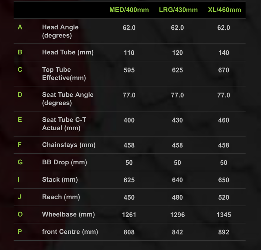

So I’ve always played around with bike setup a fair bit and definitely a fan of the whole long low and slack set up. For reference i’m 5.9” on a good day but tend to ride a large in most size frames with a short (32-40mm) stem. I use to run a large banshee spitfire with 27.5” wheels but in with 26” dropouts which I really liked (fun and poppy but with the length for ploughing at speed). I swooped the frame out to a Longer (medium) nicolai geomatron mk1 g16 which really pushed the length Of the bike (500 reach) but also chainstays (445). I find the chainstays too long for how i like to ride (the mk2 and g1 have the ability to change the length with different chips). I’ve also got a Marino steel hardtail with sliding dropouts which are set in the shortest setting. I think the mix of long front and short rear (with low bb) helps to make a fun bike but safe for me.
Posted : 22/06/2020 10:40 pm
