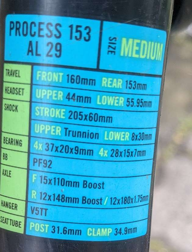

Kona Big Honzo Headset bearings. What size?
Posts: 27
Hi,
My Big Honzo is showing signs of needing new headset bearings. I'd like to get the bearings ready so I can just swap them over without having to wait for bearings to arrive.
Does anyone know what sizes they are? I've trawled the interweb and come up with precisely nothing so does anyone have any info on sizes etc?

I fear they will be cheap caged bearings, you may as well just order a posher headset, headtube size should be printed on the back of the seat tube

Thanks Sound advice. But I can't see headtube size on the seat tube sticker. As with the above image the bearing size is there but not the tube size. I assume the headset you show will fit straight in. (Excuse my ignorance - I'm a converted roadie so am not up to speed with this mtb gear!!!)
the numbers are actually the internal dms of the headtube
44/56mm semi integrated headset is pretty standard for Konas ( I have a Honzo and a Process)
