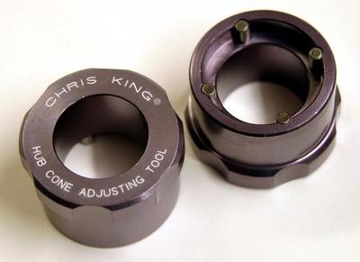

Got a problem with my CK rear hub - the freewheeling is a bit sticky, meaning that the chain flops around when I'm not pedalling. It's definitely not the rear mech, before anyone asks.

Look on the King website, they have vids to show you how simple they are to service. It takes about 10 minutes. Whip the axle out, pull the freehub out, clean, lube, re-assemble. Peasy.
Get some Ringdrive lube and get stuck in.
Posted : 14/09/2010 9:50 am
It needs a service! You'll need the tool to strip the freehub completely to get the roller bearings completely clean and the other bearing at the back. Best to take it into a king dealer if you've not got the tool. I'd do it for you but you're nowhere near me!
+1
Not a difficult job if you've got the tool kit, and the kit would only take a few services to pay for itself.
Posted : 14/09/2010 11:25 am
Posts: 97
You can give a basic service/clean without the need for the tool-kit.
You will need ringdrive lube though and adjuster tool
Posted : 14/09/2010 11:44 am
You need the full kit to do the hub shell service that's required in this case.
Posted : 14/09/2010 11:46 am
Posts: 97
A minor service and clean of the Ringdrive will reduce stiction and stop the chain slacking, this can be performed without the tool-kit.
Complete service (with tool-kit) should be performed every 12-18months
Posted : 14/09/2010 11:24 pm
Well, this hub's been through all sorts of grime and hasn't had a service in at least three years. I have absolutely no desire to buy a special toolkit for the one and only King hub I have, so it's off to a specialist for me.
