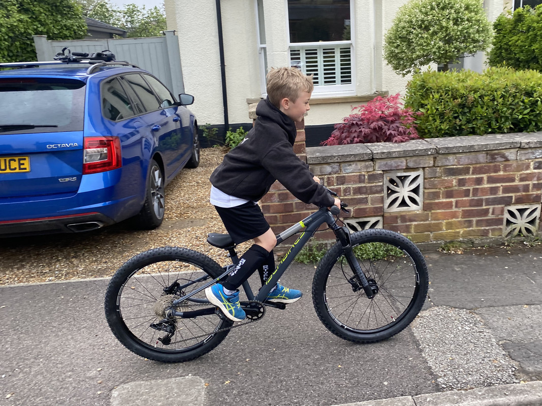

https://images.app.goo.gl/kSKhrnBzT7c6msUUA
Not hers but example image showing how high the front end is.

So if she fits an MX 20, maybe she wasn't actually big enough for the 24" Islabike? Reach / arm length is a big thing in addition to inside leg and height - all three measurements determine if a bike will fit or not.
The front end is only high relative to the fully slammed saddle - many kids bikes (especially with front suspension) are far worse. e.g. she would be years away from even reaching the pedals or floor on a 24" Carrera Luna.
It is already a short rigid fork and short head tube - there are physical limitations to how low you can actually make something around a 24" wheel. That one in the photo is also a bit misleading as there are stem spacers that could be repositioned. Do they still not make two sizes Beinn 20 to cater for this very issue, as some kids just aren't ready for the jump to 24" (even if their inside leg suggests it might be possible)?
Riser bars flipped upside down would gain you another inch or two. There are various stems with around 35 degree angle, but they'll not gain a great deal of drop as you'll also be needing a short length.
Please don't assume I'm an Islabikes fanatic - we had a 1st gen 20" and 24" before moving onto other options. I designed and made a couple of 26" kids frames after that (from scratch out of steel tubes) so appreciate more than most what goes into trying to make things fit.
Posted : 25/05/2021 1:53 pm
If the saddle is set fully inserted that would suggest the bike is too big - looking at that photo the crank looks halfway up the seatpost height, even if it was a third that would be like me running 25cm cranks (I don't).
Another indicator is knee at top, is angle dropping less than 90 degrees? Again that suggests moving up too early.
Plenty talk about minimum saddle heights on kids bikes but you wouldn't do the same for an adult if you could help it.
Posted : 25/05/2021 2:19 pm
