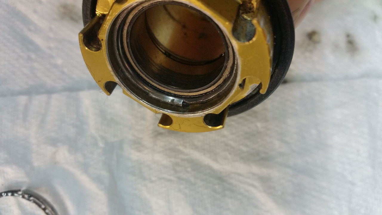

Yet another Hope hub has bitten the bullet. 2 of the free hub bearings have completely vaporised.
Is the circled bit part of a bearing?
Posted : 07/11/2018 11:30 pm
Posts: 10718
Yes.  It's about 7/8 of the inner ring.  You can see the groove that the bearings run in.
Posted : 07/11/2018 11:32 pm
Posts: 8527
Yeah, inner race of freehub bearing. IME those or the drive side hub bearing in next to it always go first  as they're pretty poorly sealed.
Generally one goes, but the other supports it, so you don't notice at first, then it goes too, and you open up n it's carnage!.
Dunno if pro4 are any better sealed.
Posted : 07/11/2018 11:47 pm
Posts: 1728
Inner bearing race, should slide off the axle (may required a puller). Outer race should still be in the freehub (blind puller works wonders, or careful use of a punch if you can access).
If you can get it  all apart and nothing is damaged it should be new bearings and good to go, however I would strip everything, clean and inspect before you buy anything in case the axle or hub shell is damaged.
Posted : 08/11/2018 9:36 am
Posts: 11464
Definitely worth dropping Hope a line. I know it's something of a cliche, but their customer service really is excellent. When the freehub bearings on my Pro 2 Evo disintegrated taking the axle with them and leaving the outer races of the bearings jammed in the freehub body, they replaced both the axle and freehub body FOC. All I had to do was send them the damaged parts first.
If there's scoring under that inner race you'll need a new axle and potentially a new freehub body if you can't remove the rest of the bearing. The disintegrated bearing parts must have gone somewhere, so it's not unlikely that they'll have caused damage.
Posted : 08/11/2018 9:54 am

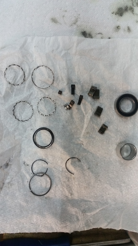

Apart from them tiny bearings this is what came out of the free hub.
Posted : 08/11/2018 10:12 am
Posts: 17263
I'm guessing the outer bits of the bearings are still in the freehub.

Amazingly with lots of heat and a centre punch the outer races came out.
New bearings and I should be good to go.
Dont really want to spend Hope prices if I can get them cheaper. Anyone got a link?
Posted : 08/11/2018 10:28 pm
Posts: 5377
Ha, mine's done exactly the same thing. Now to see if I can get the outer races out... What did you do, just warm 'n' whack? I don't have a blind puller...
Posted : 08/11/2018 11:19 pm
Posts: 17771
I removed an outer race a couple of days ago by just working a flat blade screwdriver in the small space between the rear of the bearing and the inner shelf of the freehub.
If you dig the seal out first it gives a bit more room to get the screwdriver in.
Posted : 08/11/2018 11:40 pm
Posts: 17263
For the difficult inner one I pointed a hot air gun down the axle hole .
Then using a brand new ,thin ,really pointy centre punch I hit it from the ratchet side. Amazingly it came out first go. Previous attempts without heat couldn’t budge it.
Posted : 09/11/2018 8:06 am
Posts: 1728
Freehub is alloy, bearing is steel, so if you heat it the alloy will expand more than the steel, heat gun, hair dryer, mug of boiling water, water you have.
Posted : 09/11/2018 9:15 am
Posts: 5377
Cool. Looks like that's my job tonight!
Posted : 09/11/2018 9:30 am
