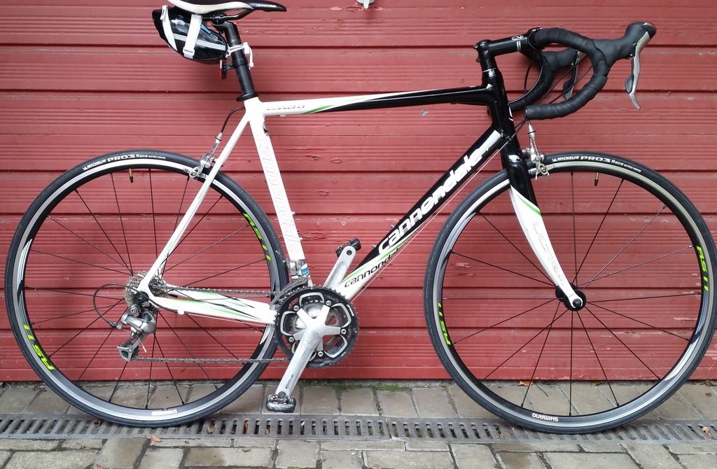

A quick question about bike setup, if I may. I'm aware that one can pay a small fortune to have a professional 'fitting' which will analyse one's riding position to the nth degree, but I thought I might call on the considerable wealth of knowledge and experience in here first.
I'm finding that I get a dull ache in the 'web' between my forefingers and thumbs when riding on the hoods, which to my mind suggests I may have too much weight on my wrists. I get a similar pain at the base of my lower back (I seem to recall from the dusty depths of my mind that back pain is indicative of being too stretched out and neck pain of being too upright?). I fitted new bars as soon as I bought the bike and I positioned the hoods at pretty much the angle I would have put a pair of bar ends in my XC racing days, but I'm now thinking they may be too far forward and low. Is there a 'correct' angle to position these? Am I just being a wuss and I'll stop getting these pains as my bike fitness improves (today's 17 mile ride was only my second since buying the bike after well over a year of no riding whatsoever).
The bike in question is a 56cm CAAD 8, which I was assured is the correct size by Evans in Glasgow (I'm 5'11) and it has the standard fit stem which, as far as I can reckon up with my tape measure (gap in the stem clamp to the centre of the headset bolt?) is a 110mm.

I'm no expert but that looks really uncomfortable.

I will openly admit I don't know a great deal about the road world but those bars don't look very comfortable like that. I think the bars should be rotated back more and the same with the levers (relative to their position now). Even with those changes the bar shape wouldn't be my cup of tea. In additiona to a better shape for the wrists you could also look for a bar with slightly shorter reach and look at some mid compacts from the likes of Deda or super short reach compacts like Pro PLT if you really want to shorten things up. Going to a smaller frame would probably see you with a ton of spacers which isn't really that wrong but will see you receive a ton of abuse on the interwebz. The bars still probably wouldn't be comfortable either even with a smaller frame 😀

To me the hood position is way too far forward and down.

Rotate the bars up slightly and fit a shorter stem, I've had similar problems to you and recently fitted a Deda 70mm stem as opposed to the 110mm one it came with and things are much better.
Posted : 04/10/2015 2:43 pm
So the entire bar needs rotating back a bit? I just kind of assumed that the flat part at the bottom of the drops should sit parallel with the ground. Shape wise, they're Easton EA70, so I would have thought a big manufacturer like that would know a thing or two about what shape to make them and wouldn't be unlikely to get it drastically wrong, or have I unwittingly bought a known 'lemon' in the world of road bike bars?
Replacing the frame with a smaller one seems very drastic (not to mention expensive), especially given that Evans reckon a 56cm is spot on for me. Surely there must be a multitude of adjustments with bar/lever position, stem length and saddle position that can be played about with first?
Posted : 04/10/2015 2:49 pm
[b][u]deviant[/u][/b] - [u]Member[/u]
Cheers, I'll give that a whirl.

I'd consider different shifters - I had 5600 105 which look to be the same shape as yours (tiagra/sora?).
Huge pain where you're suggesting you get it.
Fixed by changing to 5700 shifters which have a much wider flat area to spread the load.

Fwiw I also found to improve pain in shoulders/arms/hands I actually lowered the front end which made a huge difference. I also found it improved the bike handling with much more weight on the front.
Anyway, have a play, see what works for you.

First of all a fit is well worth spending money on.
I am 5"10 and ride a 56. My arms are long so run a 100mm stem now with zero rise.
Keep the flat parts of the drops to start oof horizontal. Place your elbow on tip of saddle and measure how far centre of stem is away.
Check out lemond fit (worked for me).
I had bad pain like you with 130 mm stem and - 10 degree rise. Switching to the 100 zero pain went away overnight.
Thing is a 56 from one manufacturer can be a 52 - 60 in another.... Like shoe size.... I wear size 9 nikes but need an 11 Adidas shoe.
Again get a fit done mate well worth it. You sound like me, bang in between sizes. Both can be made to work but you need to know what you are doing.
Good luck

The saddle to bar hight looks spot on, size wise I'd say its pretty good. But as others have said your levers look miles away !! Move them up the bars a bit then rotate the bars a touch. Try that for a few rides before spending money on compact bars.

Posts: 39665
They might be easton but that bar shape is from 1992
The distance from your tops to the hoods is massive.
Sort that before changing stem do not stick a 70mm stem on ffs.
Sorry to be thick, but do you mean the part highlighted in red or green?
Posted : 04/10/2015 3:18 pm
Posts: 41395
he means green. I prefer them tilted slightly up.
Your bars are long (to the levers) which as TR says is probably at the root of the problems. I run a 58 'dale and 11/cm stem, and am 2" taller than you and well used to a road position.
Posted : 04/10/2015 3:25 pm

To be fair any bike fit advice given to an image of a bike without you on it should probably be discarded without reading! Post some photos with you on it.
That said the bike doesn't look like it's been raped to fit an oaf it is not intended for. Saddle to hoods all looks pretty reasonable. A lot of newbies tend to position their STI pointing too skyward to bring them back. The attitude of yours relative to the ground is about right imo. You have achieved that by having them (imo) a little too far up the bars and the bars tilted a little too down. Changing both will probably have the hoods in about the same place in space but with a slightly flatter transition between bar top and hood. The older STIs created a bit of a 'hammock' with the bars, of which yours is an accentuated example. Modern bars and newer stis do make a better transition and flatter top with more hand positions available. I still run some 9spd Dura Ace STIs on one bike but have used a couple of sachets of sugru under the rubber to improve the shape and transition.

Try with the red circled bit above horizontal. Do a google image search for 'road bikes' and you'll see that's the most common way of setting it up.

Wouldn't saddle to bar drop all depend on the rider's flexibility rather than what it looks like from a photo?
From the photo's with the coloured circles, I'd rotate the bar up so that if a marble was placed inside the bar. it would 'just' roll out and then move the levers down so they are vertical or as near as damn it and then make very small changes from there to suit. Maybe experiment with spacers under and above the stem to lift or lower the bar. Remember that any adjustment you make to your bike set up is not in isolation. It will have some effect on other parts of your position as well.
i'd say the bike frame size is correct for your height in as much as generic sizing can be. My 'Dale feels long for what it is.

trail_rat - that bike has pretty much a horizontal top-tube. I'm not sure many well-fitted riders would have much more seatpost showing on one of those.
I'm sure it would look more "normal" again if the stem wasn't spaced up

As i thought no 70mm stem required - my comments regarding sizing were purely if it transpired he needed at 70mm stem....
Rotate the bars up slightly - not much . Then uwrap your bars and move the hoods up.
The drop portion will have a slight "angle"
But the sti/bar position being downhill is making you force your hand into the sti

There's some lines on these pictures; it might explain it a bit better. I know very little about the human anatomy, but I think the lines do the job to show you where you're going wrong.
Posted : 04/10/2015 9:57 pm
You're sat upright by the way, mr panache below is sat how you should sit on a road bike.

A picture (or, in this case, two!) paints a thousand words, thanks. It seems the main thing I need to do is relax my arms at the elbow to drop my whole torso down?
As alluded to by others upthread, I come from an MTB school of thinking, where extending your fingers should see the controls fall naturally under just under them with your arms, hands and fingers in one straight line. My thanks to you (and everyone else) for taking the time to educate rather than a flame a newbie.
Posted : 04/10/2015 10:03 pm
No, I don't think so. I don't think you'll be able to relax your arms; they look stretched, as if you're reaching for the bars. You shouldn't reach for the bars, you should do what t'other laddo is doing; let your hands fall onto them.
The problem is the vertical line in your picture, it needs to be rotated forwarded like laddos. Sit on your bike, leave your feet off the pedals and just roll forwards; you'll end up not sitting on your sitt bones.
Posted : 04/10/2015 10:12 pm
[quote=relliott6879 ]A picture (or, in this case, two!) paints a thousand words, thanks. It seems the main thing I need to do is relax my arms at the elbow to drop my whole torso down?
Yes and no, chicken and egg. Because what you need to do is sit a bit less upright by increasing your hip angle. Bending your arms a bit is a good way to achieve this - though I'm sure the first thing which struck most of us looking at your pic was the straight arms.
I certainly do think this is an ideal you should consider aiming for - however I'll throw in a note of caution. We're talking about a fairly* aggressive roadie position, one which many people aren't comfortable achieving and a lot of people are happy sitting rather more upright than Mr Panache (some of them have medical reasons they can't achieve that). It should still be possible to have a comfortable hand position even with a more upright position - and to some extent you did identify correctly that for your current hip angle your bike is too long, which is where the 70mm stems come in. It's not something I'd want to encourage, but nor would I want you miserable if you really can't manage a more aggressive hip angle.
* it's relative - I have a flatter back than Mr Panache, and I'm probably not far off his position on a MTB.
Posted : 04/10/2015 10:16 pm
Why are some people not comfortable achieving that position? If you look in the pro peloton; there's quite a few riders who have awkward looking positions and are sat quite upright like the OP. What gives?

Seat looks too far forward to me, do the plumb bob test. Having the seat further back will allow your hips to swivel forward and give a better back position. It will stop you hunching up over the bars which gives pain to hands and shoulders, neck and back. As you get lower your arms can relax and it actually takes the weight off. (opposite to what you'd think)

The reach is too long, partly due to the shape of shifters (they add a cm to the reach compared with higher end versions). Swap to a 100 mm stem (or even a 90) and rotate the bars slightly so the drops are not parallel to the road (about 15 degrees works well for riders who are less flexible. You should more some bend in your elbows when on the hoods. You should also be able to use the drops, and bringing them closer will help a lot.
I'm 179 cm and ride a 54 CAAD8 with a 110 mm stem.

Fair point, except I have the same bike in the same spec with almost the same geometry, just one size down and longer stem. I'm also the same height. But proportions may not be similar. It is, however obvious from the first picture that for the hip angle, more elbow bend is needed and that the drops are not really going to see much use.

Does this look more like it?
The stem is definitely a 110mm, by the way (assuming I'm measuring between the correct points?).
