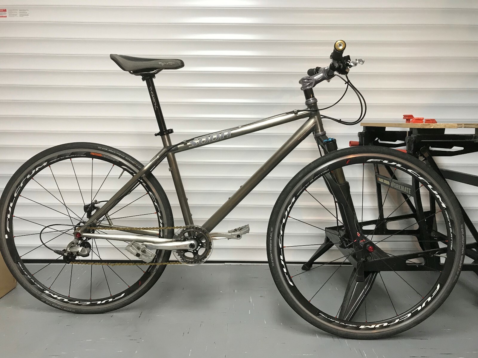

you can if you buy this one:
Cotic Soda, Ebay
Posted : 26/02/2019 12:15 pm

Posts: 9
Thanks muffin, that looks great. That's all I need.

Not sure why you would. If it were disk I'd go 650b with slightly chunkier than normal tyres 1.5 slicks or something.
That's a crying shame that Soda dressed up like that :-/

That’s a crying shame that Soda dressed up like that :-/
Don’t shout at me - but I’m considering turning my Soda frame into something similar...
