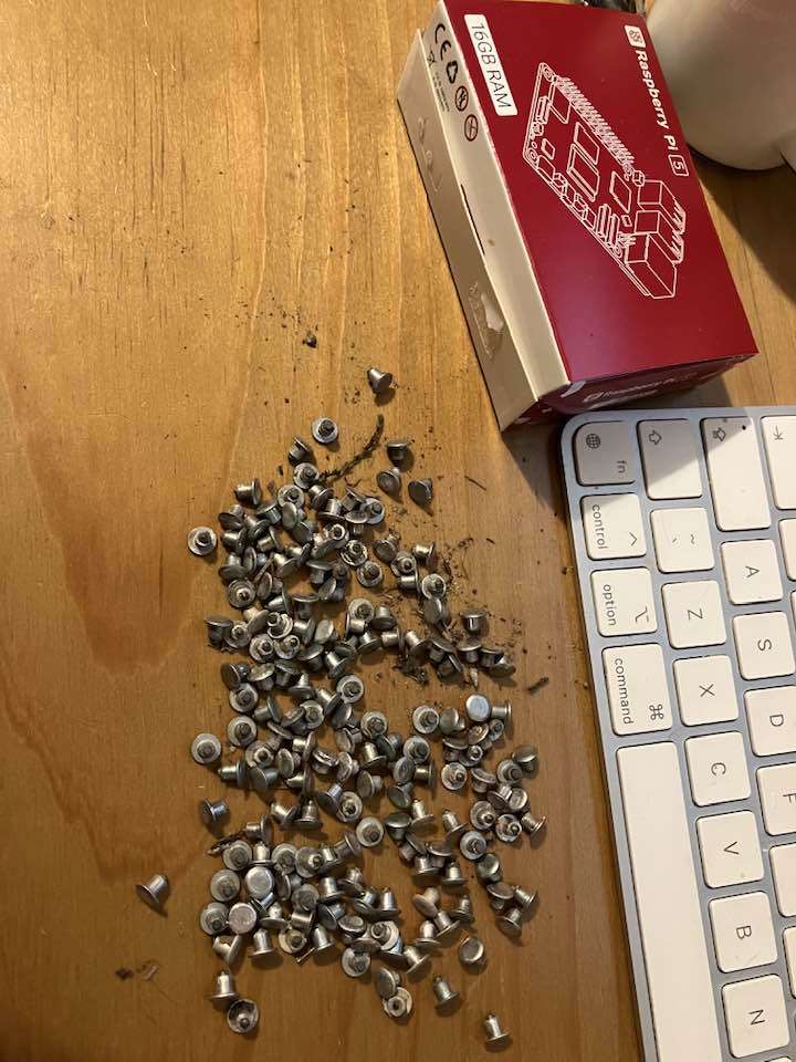

I took a walk around the StrathPuffer course today. It's littered with bright shiny ice studs.
I picked up a few but quickly got fed up of all the bending, otherwise I could have had a sack full. What I noticed was that all of them had a bright and shiny head which suggests that the tyre had not been run in before the race - something Schwalbe advises is necessary.
On studs I have removed from my own ice tyres the heads are dull and discoloured because of rubber smears. They were properly run in. Mind you, doing that does not guarantee you won't lose some studs, but they seem to stay in the tyre better.
I can understand why people shortcut the running in process, it's bloody awful grinding along on tarmac with ice studs.
Failing the running in, is there another method? I was thinking along the lines of heating studs on a hotplate before insertion, ie get them hot enough to promote a bond between stud and tyre. Anyone tried that?

With schwalbe I did the proper bedding in once and still had a couple of studs come out on the first proper ride, so the other times I just did a single short road ride and then a gentler offroad ride and tbh it seemed no different, the only thing that did make a difference was just going out and riding on them on dirt normally on the first ride, that was bad.
Someone recommended me rubberised superglue for fitting replacement studs, does it help? No idea tbh, they still do come out. I just accepted that you have to check and refit studs pretty regularly in the end.

Are the studs ferrous? A magnet on a stick is a fine tool for anyone to own. Would help clean up the trail on your next outing if you fancied a tidy up.

Likely a few of mine in that picture.  I lost a few this year due to the rubber studs starting to open up.

Seems a bit of a waste - it definitely wasn't a year that needed ice tyres!
I have often bought a set just in case, then sent them back. Having seen the state of some ice tyres this year though (50% of the studs gone) I'll just get some and bed them in for next time.
