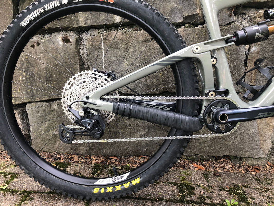

I'm looking for some advice. Within the first month of owning my brand new Ibis Ripmo V2, I noticed that the metal chainstay protector had come off during one of my rides. This left the chainstay exposed to chain slap, which caused some pretty severe chipping of the paintwork, and even gauged the carbon beneath it (photo below).
My bike shop made a warranty claim with Ibis on my behalf. However, Ibis responded that the best they can do is to send me a replacement metal plate to glue back on.
Obviously, I'm not happy with this response as this is clearly a manufacturing/design fault on the part of Ibis - the protector failed to do its job within just a handful of rides. You will also notice that the drive-side chainstay swoops down, thus sitting closer to the chain than on most frame designs - this is because Ibis wanted to keep the chainstays as short as possible (otherwise they would interfere with the chainring). Knowing this, they should have probably thought about reinforcing this area better against chain slap.
Now, I know that this is predominantly just cosmetic damage, but I'm annoyed as it will hinder the re-sale value of the bike. I just expected better from a brand like Ibis.
Here's a picture of the damage:
Ibis Ripmo V2 chain slap damage
For reference, here's an image of a Ripmo V2 that I found online with the metal plate attached:
Ibis Ripmo V2 chainstay with metal plate protector
Posted : 25/08/2021 12:42 pm

Just the remainder of that one ride without the plate?
I still think costmetic damage is pushing it a bit though, sorry.
Not necessarily. See it from the POV of a company who's probably seen a few of them jet-washed off, doused in bike cleaner that's killed the tape, etc.
It's a manufacturing defect if the tape was duff and it fell off but that's hard to prove either way. So while the damage isn't a warranty-able fault the reason the metal plate came off could be up for discussion.
Outcome might depends on the stock they have and how it's approached by you or the dealer - it may be down to goodwill rather than a clear warranty case.
Looks like they did as it has the metal plate and to be fair to them it's a sensible way to do it. You could bolt it on but then some high chain pressure (a jam etc) might damage the carbon more easily. The way it's fitted is a bit like a mech hanger, it's a fail point / saver. Drawback is it needs spotting early before damage happens.
I don't know exactly when the plate came off, but I would say 1-2 rides max, as I would have noticed the plate missing while doing a regular wash (it's been nothing but mud this summer). I live in the Alps and the trails here are rough, so this could easily happen within a single ride.

Chain slap or chain suck that close to the chainring? I'd have thought slap occurs in the middle of the stay. Was it a new frame or full bike? Reason I'm asking is if it was an old drive chain that 'sucked' and knocked off the protector, then that's user error IMHO.
Posted : 25/08/2021 1:15 pm

Chain slap or chain suck that close to the chainring? I’d have thought slap occurs in the middle of the stay. Was it a new frame or full bike? Reason I’m asking is if it was an old drive chain that ‘sucked’ and knocked off the protector, then that’s user error IMHO.
Brand new everything.

I don't have anything to offer in terms of whether it should be replaced or whatever, but I always get concerned when people talk about resale value of a bike - I don't understand why people buy a bike with thoughts of how much they'll get when it is sold on...I don't tend to buy stuff and look to sell it on as it tends to wear out, so I'm sure I'm not thinking the way I should be for resale value. It strikes me as odd.
A mountain bike ridden hard is going to show signs of usage, so accept it, enjoy the ride and don't rely on a massive amount as a resale amount if you do decide to sell it on.
Can you wrap that bit in inner tube? It will provide a bit of protection and could also dull the noice a bit.
I'm assuming you are running a clutch mech? If so, is the clutch on? I'd have guessed a clutch mech would reduce that amount of skelping - however, looking ta the picture, the stay does dip quite a lot so could be right at the point where the chain does 'flick' so strikes may be very common there.

FWIW - Ibis have had the same or similar metal protector on their bikes since the original Mojos and the DW Link design with the dropped DS chainstay is also common.
To get that amount of chain rub/slap, you must've been toward the bottom of the cassette for a decent period of time...perhaps a bit more b-screw tension would've helped?
It's a good tip and exactly what I have done:
I’m assuming you are running a clutch mech? If so, is the clutch on? I’d have guessed a clutch mech would reduce that amount of skelping – however, looking ta the picture, the stay does dip quite a lot so could be right at the point where the chain does ‘flick’ so strikes may be very common there.
Yup, I always keep my clutch on while riding.

Ah, now I see the full photo, I can well imagine the slap. I'm not cosmetically precious about my bikes, but I'd be annoyed by that on a boutique steed.

FWIW – Ibis have had the same or similar metal protector on their bikes since the original Mojos
Yup, and they've been falling off for most of that time too. The official fix used to be "araldite it back on and it'll stay on", which seemed to actually be true, which raises the question what the hell are they doing in the factory.
But that's a hell of a lot of chain slap damage for one ride. Not casting aspersions on the OP or anything but I suspect their warranty dude's looked at that and gone "one ride, my arse".

But that’s a hell of a lot of chain slap damage for one ride. Not casting aspersions on the OP or anything but I suspect their warranty dude’s looked at that and gone “one ride, my arse”.
Fair point. I imported the bike from the UK, since it's impossible to get your hands on these in Switzerland until next year. The Ibis rep probably thinks that I ride it in the South Downs though (where the shop is located).

Looking at the picture of the stay and chain in the lowest gear, you can see how close the stay is so I'm reckoning that is entirely possible in 1 or 2 rides of some real rough bumpy stuff. I hadn't realised it was quite that close, but hopefully the inner tube is going to do a decent job.

If I were you I would glue it back on, keep the tyre wrap going and in a couple of years time if you sell, it think it will be just part of the patina of a used bike.

The area where most of your paint damage os isn't actually covered by the chainstay plate.
Its alot of damage for one ride regardless of where your riding id say though. In ibis' defence its for chain suck, not slap. You need to weigh up frame protection on your own i guess.
Also, its handy enough to repair, ive got two ibis bikes atm and ive installed the chain suck plate on one of them. Clean it, rough it up, fill the chips, paint and then bond the plate on. Make sure its all degreased and your epoxy is nice and warm. It'll never come off again.

Posts: 96
Its a chainsuck plate, not a chain slap plate. Its function is to protect the frame in that scenario.
Posted : 26/08/2021 1:03 pm
Posts: 312
Fistly, this:
Chain suck? in 2021? On a full sus with 1X gearing? Seriously? Not being sarky, is that really a thing on any bikes that modern?
Secondly, even if chain suck was still a thing, that plate won't protect the frame from it - it's too far back and too low:
