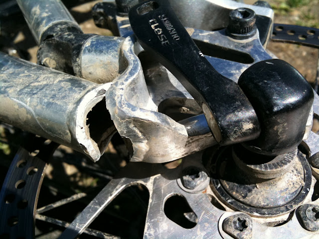

Back from the alps now... managed to snap the swingarm on my old style 575 :o(
I was 'just riding along', down a 'french red' trail in Valloire (which is an awesome place by the way)... rode around this corner:
and this happened:
BUGGER!
I have emailed Yeti in the states... so watch this space to see what happens!

Bad luck...
Out of interest, how old, what's the warranty on it and just what are you expecting?
The fact that it broke when you were JRA just means that it had got damaged enough to break earlier when you were probably giving it more beans.

Its a 2006 frame... I didn't buy it new; I bought it from the classifieds from GoogNoog (now called goog, I believe).
The JRA claim was a bit tongue in cheek... I've ridden this bike properly for quite a while - this is its 3rd summer in the alps, plus plenty of fun in Wales.
But! I still don't think it should fail at the weld like that; I think the weld went (possibly assisted by the turning moment from the brakes), and the carbon hinge went as a result.
I'd love for Yeti to give me a brand new ASR-7... but I would be over the moon if they gave me a new frame, or even just a new swingarm.
Most likely, I expect they will sell me a new swingarm at cost; and that would be fair of them. I've sent them a friendly email saying that I love the bike, and can't really afford to replace it at the moment.

Seriously though it is irrelevant where it broke - it was cracked for a while, just waiting to go, thankfully not while you were pulling out in front of a bus etc.

I know of two local 575's where the carbon swing arm has 'just' gone. One at least was witnessed by a few of us and the bike was out on it's first 'proper' trip.
As everyone on here said when it happened 'tough' 'stuff breaks' etc etc.
The old swing arm is still in the shop, you can see it's imaculate not an external mark anywhere.
The guy still rides his older ASR? light full suss?? everywhere.
Not good.
Posted : 18/08/2009 4:49 pm
by the amount of yeti rear swing arm replacements i see on peoples backs at events like mayhem, i think they break quite often...
Posted : 18/08/2009 4:55 pm
There seems to be a problem with carbon chainstays on the latest models of 575. The Yeti forum has several guys who have had theirs break. Of course Yeti maintain that there is no design fault, but one break is unlucky, two is a coincidence and three or more seems to indicate a problem. Why would anyone want carbon chainstays on a mountain bike? They are in the line of fire for all the crap thrown up from the trail - an accident waiting to happen. I bought alloy stays on my 575, and have had no problems.

I'll be having a closer look at my 575 swingarm, its done a couple of Alps trips, Scotland Seven Stanes, Wales etc.. What size disk have you got on the back, looks like a 180mm.
Posted : 18/08/2009 7:10 pm
It is a 180mm xt - which is what their documentation says is the maximum allowed.
And it is the alloy swingarm (as the pictures show!), not the carbon one.
I know that the chances are slim, considering that I'm not the original purchaser, but hoping they will at least let me buy a swingarm... with some sort of discount!

Discs look pretty normal (for an alpine descent) to me easygirl, certainly my hope mini rear looked like that just before it boiled and stopped working entirely 😀
Posted : 25/08/2009 11:27 am
Seems to be a normal Yeti faliure that's where they tend to go.
JRA to the pub/shops is oddly the most common form of warranty issue 😉
Posted : 25/08/2009 11:31 am

BrokenCollarBones - sure that wasn't a rear mech problem... it seems to have sheared the drop out off. Like when you pedal when you shouldn't when your chain is jiggered.
Posted : 25/08/2009 11:47 am
IIRC a replacement rear triangle is around £400 under Yeti's crash replacement scheme
I could - however - be confusing it with something else
Posted : 25/08/2009 11:55 am
thebikechain - happened as i was going up a climb, chain did slighty jam but thought the mech hanger should have been alot stronger.
Posted : 25/08/2009 12:01 pm
mech hanger stronger = busted XO mech. Did exactly what it's designed to do in my opinion.

as above, if you weren't the original customer they might help, but they're under no obligations.
and yes - the mech hanger is a sacrificial part, more to protect your frame than anything else.
