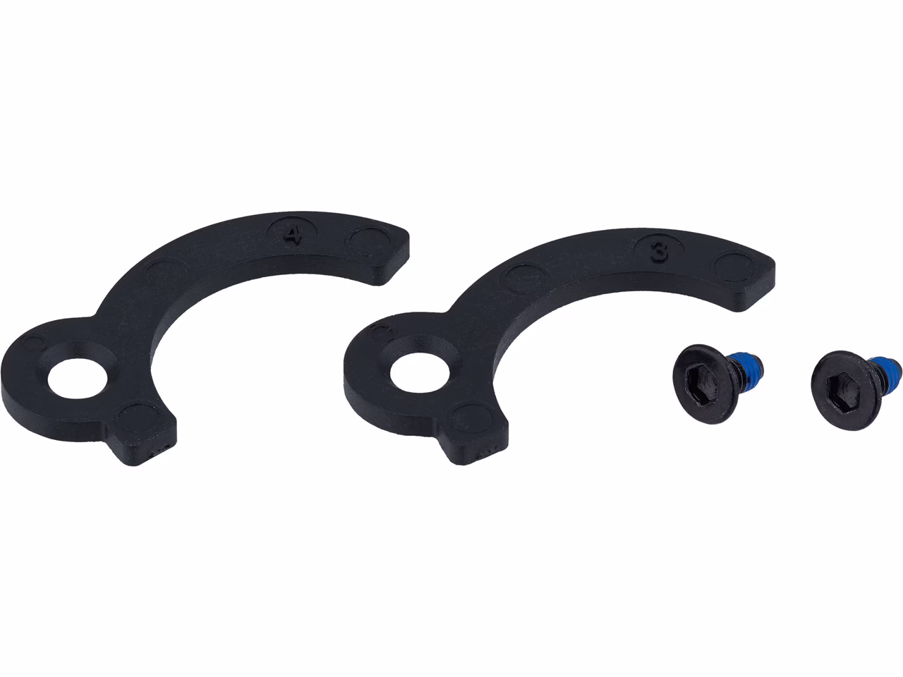

If you buy a proper aftermarket rockshox they also come with some little horseshoe shaped parts to fit to the dropouts which stops your non torque cap hub from flopping around and being awkward to poke the axle through.
https://www.tftuned.com/rockshox-fork-hub-endcap-adapters/p4098?srsltid=AfmBOooyGvZFkMoaeAsS3SoUKHcuv2afNQKZvTkimgv5bC3ExG9EnG30
Posted : 21/06/2026 9:47 pm

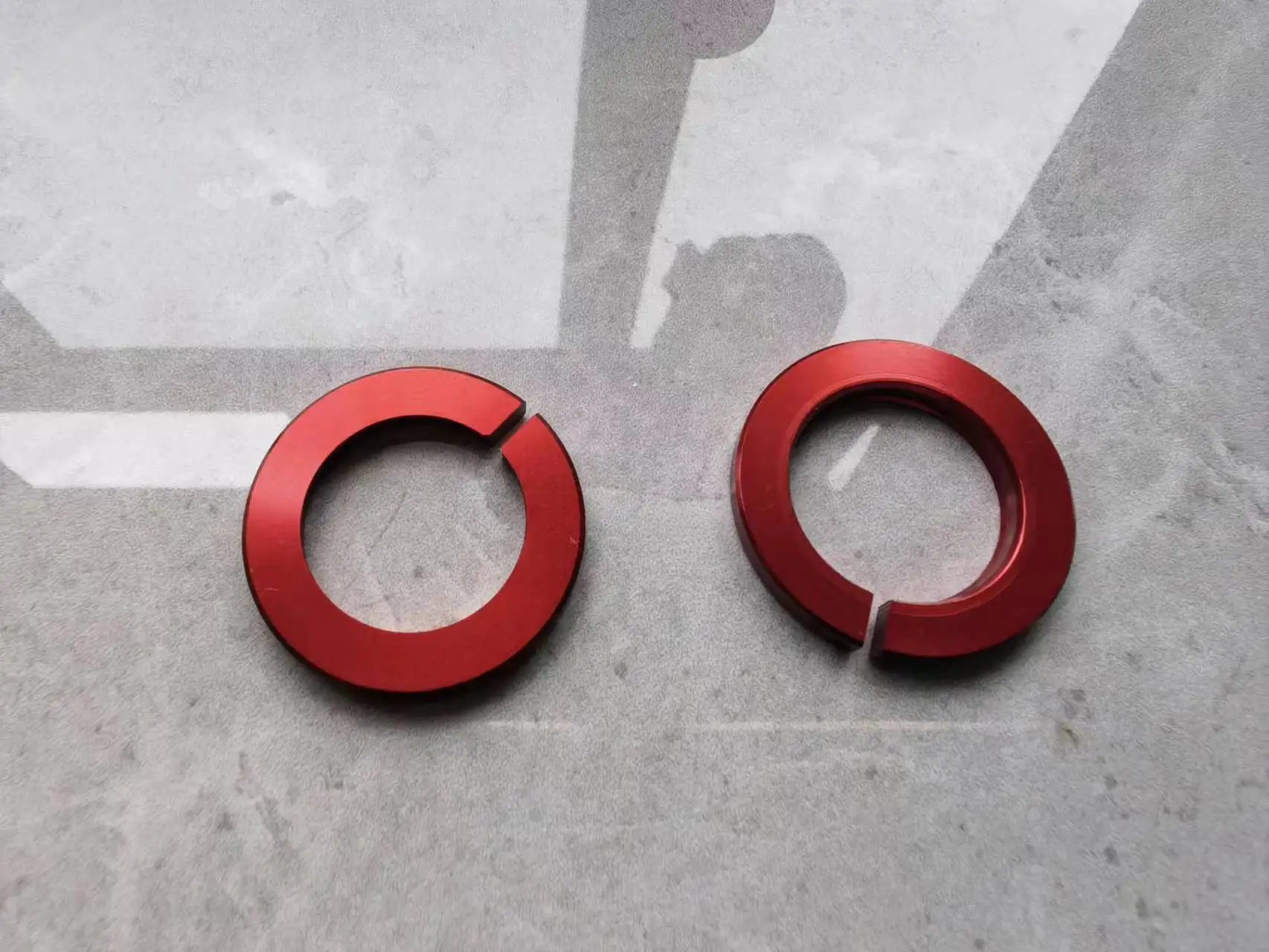

These look like a ring that could be bolted to any 15mm adapter to gives the extra flange;
https://www.bike24.com/p2302602.html
https://www.aliexpress.com/item/1005012135594786.html
