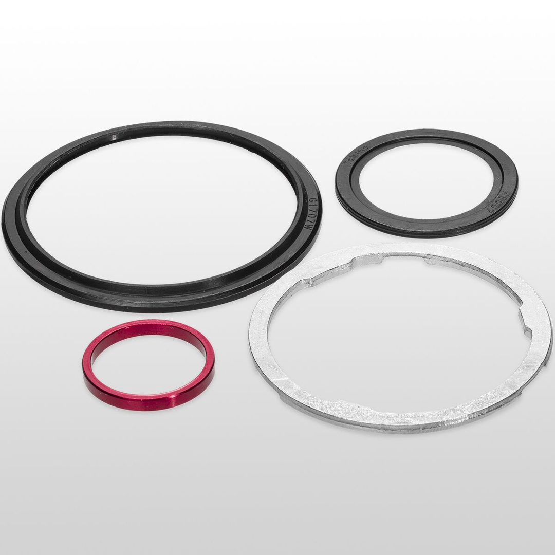

update. Theres tiny tiny text on it, G1707W, which leads me to this kit.  image.png
which appears to have the correct seal (the big one) with the text visible.
Also, this kit:
https://leelicycles.co.uk/stans-notubes-neo-freehub-seals?srsltid=AfmBOopaJkwmZy62kEcc72iMEH2uY6Qgf0grAQhrdK3teiOPRVDQGC0oZaY
visibly looks to be the same, and also includes the big flat seal from the other end of the freehub. (mine are Hunt EnduroWideV2s)
which suggests this might be a hub sold under many names. Lovely.

annoyingly i think looking closely at the stans kit, its a single lip seal, rather than the double on this hub. The Reynolds kit in the image contains the seal, as you can read it on the picture, but the other parts dont look relevant.
That image takes me to a "no, because tarriffs" page, which is very irritating.
I guess different arrangements use different seals in different places, and mix and match the options.
