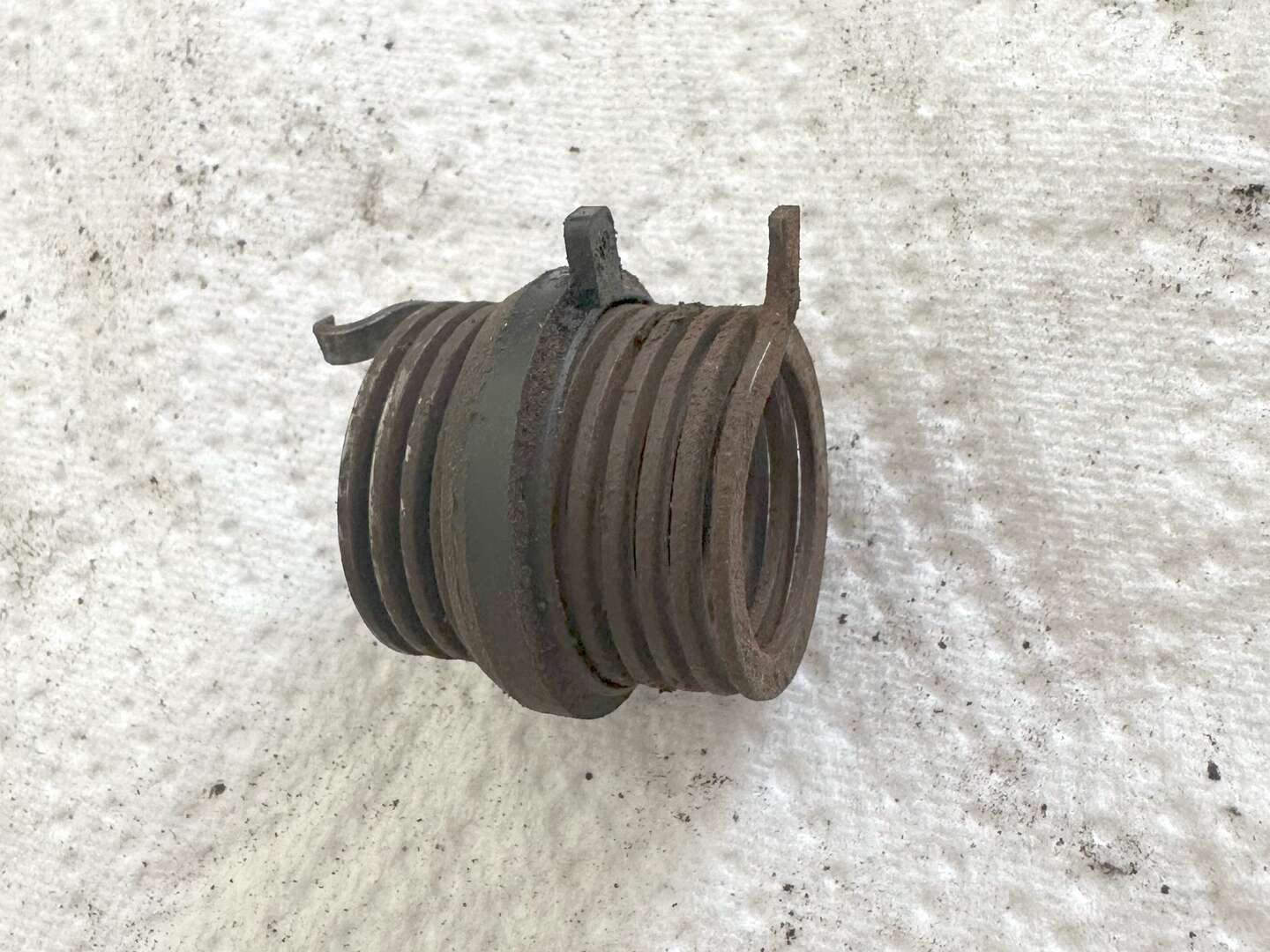

This was how my spring looked after removal but before cleaning - signs of rust and didn't clean up anywhere near as well as that of @montgomery in the picture above:
Worse though was the P-axle - the one that goes all the way through and forms part of the clutch mechanism on one side (where the hex key is inserted in montgomery's top picture) and the nut for the cage mechanism on the other. That was not moving freely beyond a range of approximately 30°, to the point where the chain was sagging in all of the high gears because the cage wasn't rotating to take up the slack. I removed the axle (with a lot of GT85, persistence, and expletives), cleaned everything with IPA, smoothed off the axle and its housing with some fine emery paper, greased and reinstalled, and now it's working fine. To be fair, until the last month the derailleur has worked flawlessly over 7000 miles since I bought it (second hand off ebay, so no idea how much use in total), so I'm not complaining.
