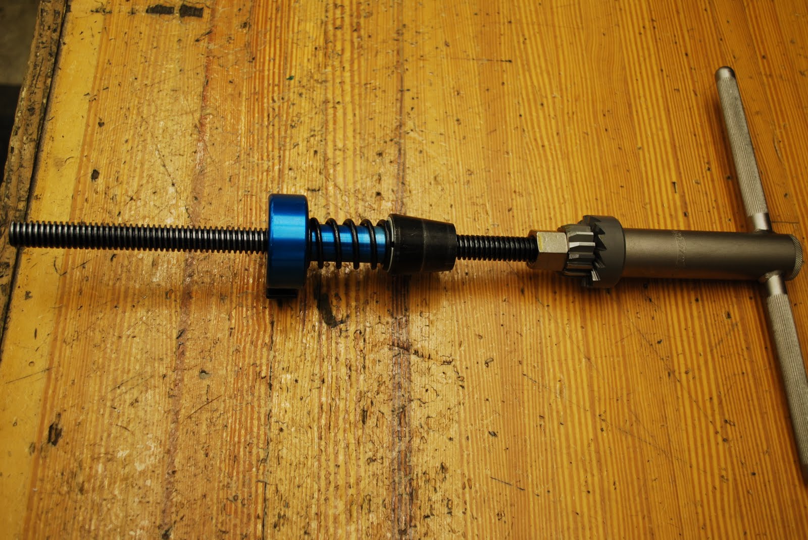

If you want to do it properly on a new frame then you should invest in a reamer as well as a press - significantly more expensive I'm afraid. At the very least make sure you scrape off the paint on the ends of the head tube first.
It also depends a bit on the headset - some (I've found especially Crank Brothers) are difficult to get in straight, I ended up making a tool to help with this.
Grease the inside of the headtube well before fitting.

Posts: 1617
Sam - Member
don't you mean a facing tool? Reamer makes me think of the bore itself. I wouldn't have thought you want to mess with that.
I just use an assortment of sockets that I have lying around for the car with some threaded bar and nuts and washers.
I would rather use a proper press though - It is something I will buy soon. You have to be very careful with sockets but it can work well and nice and straight. Did my first one on my carbon 456, then on a scandal and then an inbred for a friend.

 Sam
Posts: 2390
Reaming/facing is usually one tool so that it's reamed to the correct diameter and also faces the tube perfectly square.
Posted : 22/03/2012 11:56 pm
Posts: 1617
ahh cool, only seen the facing bits before, maybe it was a BB one - wouldnt want to ream one of them!
I've never really understood why frames don't come faced but had never considered the bore might not be right either. Guess it's one of those jobs that falls into the "if you want a job doing..." categories when you are a bike builder.
