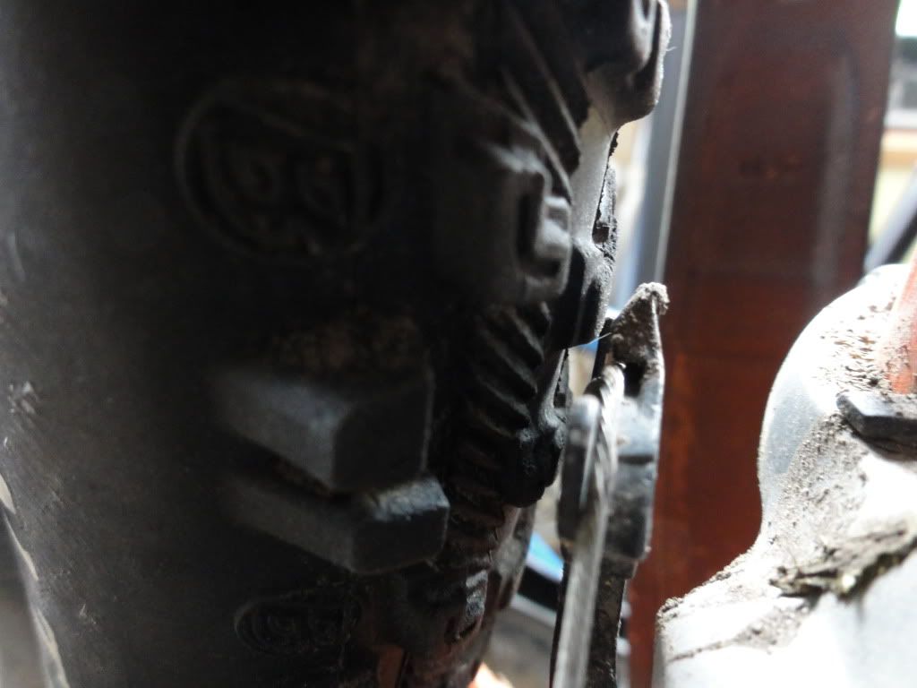

The biggest problem for me is, the front mech cable routing. It is a under the bottom bracket type, so a bottom pull front mech is needed.
I tried a low mount one, but the clearance was poor so I put a high mount one on and I am shocked at the clearance lol Take a look at the pics below!
Anyway the tyre is a Bontrager 2.2 width and not a fat tyre.
If only the front mech cable routing was a top pull set up I could cut the unneeded arm of the front mech off, giving loads of clearance!
Such poor design guys, really disappointed...... The thing that makes me laugh more is that just after I bought this, I notice they changed the cable routing! So I guess it's an admission that the design was bad? If only I could swap this one for the slightly newer version I would be loving this frame.
Sorry the reason for the post was to ask others in this situation, how they overcome this? and don't just say "go SS" I would but we live in a hilly area and I like my knees in one piece.

Lots of front mechs are lower profile than the one pictured and will have greater clearance, its not a design fault of the frame, most 29ers are tight in that area.

try a sram mech?
Posted : 06/06/2012 10:17 am
Posts: 7563
Could you use a seat tube mounted roller, higher up the seat tube to turn the bottom pull into a top pull, then you could cut that arm off?
Posted : 06/06/2012 10:19 am
Top swing, bottom pull.
Posted : 06/06/2012 10:22 am
Try one of [url= http://www.ebay.co.uk/itm/New-Frame-Cable-Stop-Alloy-Double-34-9mm-Black-/130679406625 ]These[/url] with a high band top pull mech, or a high band multi pull with the bottom pull arm sawn off

My Chumba is almost as bad as that, so I went 1x9
Posted : 06/06/2012 10:45 am
+1 for Khani's solution with a full-length outer.

Stoner, does the cable just go straight onto the mounting bolt from below?
Posted : 06/06/2012 10:48 am
I thought Stoner had cut the bottom-pull element off, leaving his XTR a top-pull only.
PaulD

Didn't notice any issues with my green 21'' swapout frame - that said I was using a M950 BP mech with non of this new fangled dual pull "stuff"
I ran mine with a largish volume 2.1'' WTB tyre and the chainstay/seat stay clearance was more than ample.

I took the same route on my original Scandal 29er as Stoner but my frame is top pull. I have the same front dérailleur as you by the looks of it (older XT).
Going to need to find one with bottom pull and no gubbins sticking out of the back as I don't like the roller method mentioned above. Too much faff and messy looking.
I would rather fit a clamp on cable stop and run the cable from the top, thus solving the poor routing and cross over below if you want to have your cables wrapping round the front of the headtube as most of us do.
On my Scandal I gave up and mounted the cables so they don't cross over round the front of the head tube. I hate it and it rubs on the frame but it was the neatest way in the end as my inners where a bit too short.

Yea Stoner, I did that on my other frame but it was a top pull. very neat and gives loads of clearance.
Posted : 06/06/2012 11:15 am
yea gonna try a SRAM mech.
At the moment I am running it as is with a skinny Continental rear tyre.
The cables do cross ynder the downtube as suggested, that's fine but the daft boss for the brake cable is in the way and already wearing the paint off.
Oh well not to worry it was just a stop gap frame anyway, so no harm no foul I guess. Just dissapoined in poor cable route choices.

Shimano CX-70 cyclocross mech helped clearance issues on a 29er I built recently. I think the CX mech is designed around a 50-34 chainset though.

Brant, yea that might work. Need to track a roller down and try it.
