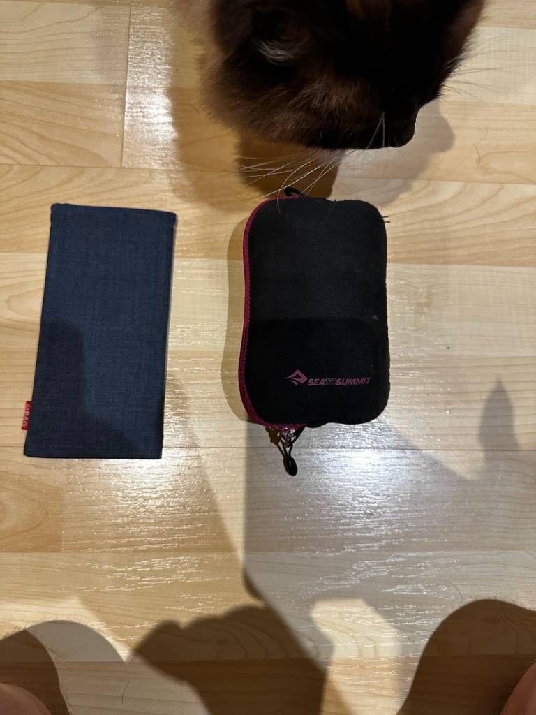

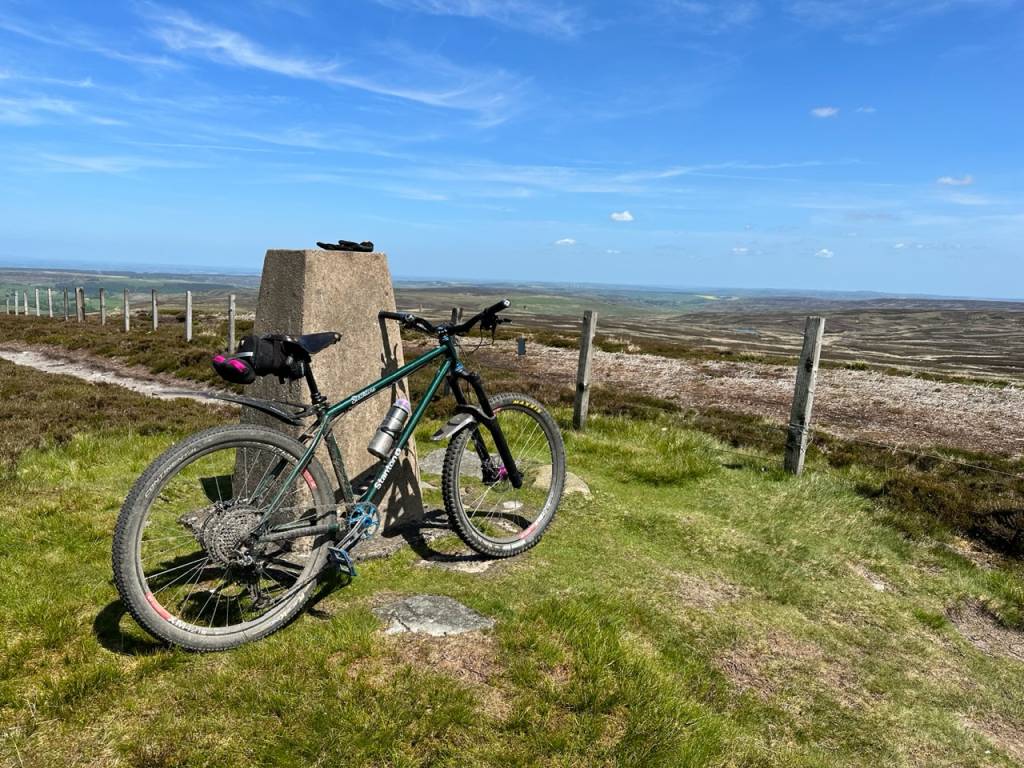

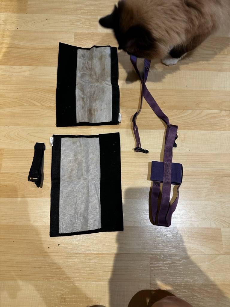

Posts: 1134
I use a Topeak QR Cage Mount with a bottle carrier strap and a couple of Velcro seatbelt covers. The whole lot costs about £25, weighs about 150g and fits in a little Sea to Summit bag:
Sea to Summit Bag
Bag Contents
It straps onto the light loop on my saddle bag:
Bike
When I need to carry I put the cage and bottle in the carrier and put the seat straps and case over the QR cage mount. It’s not perfect, but it does make carrying more bearable (for me - first used in anger on Nan Bield last year).
Sorry about the Amazon links (and the cat - although at the very least it makes a good cat toy).
