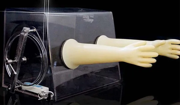

Posts: 14140
I have one of these hoovers at work - just the job!
Posted : 08/11/2017 2:16 pm

all this and you look sexy as hell too ๐Ÿ˜‰
Posted : 08/11/2017 2:25 pm
Posts: 25921
rene59 - I'm sure it's great and all but for me, a sex-robot has to be prettier than that
Posted : 08/11/2017 2:27 pm
