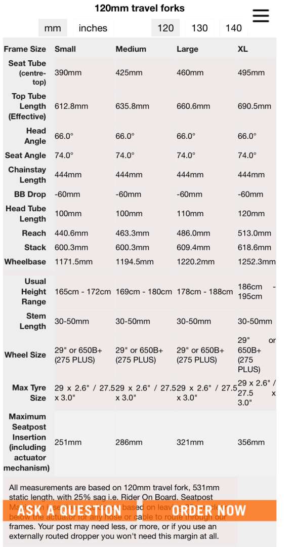

To my simple, untrained eye the geometry of the current Solaris and the last Solaris Max frame are very similar for a sagged 120mm fork.
The first table is the last gen Solaris the second the current:
The current version is advertised as being able to run a 100mm fork but the previous version is advised as needing a 120mm minimum.
Based on the above I can see no reason as to why the previous version wouldn’t work* with a 100mm fork.
What am I missing about why makes the latest version different?
All help in addressing my confusion would be very welcomed.
*I appreciate you could stick a 100mm fork on the previous generation and you don’t need a table to tell you that but I am curious as to what I’m missing as to why it might not be recommended
Posted : 10/09/2025 11:42 am
Posts: 3307
Stack is a 11mm higher on current version? So longer fork would increase that even more. But i still think thats no reason to not put a 120 fork on it. Plus thats the cotic table isnt it? In which case they also think 120 or even 130 works fine.
But as an owner of a number of cotics my answer would simply be to ask them directly.

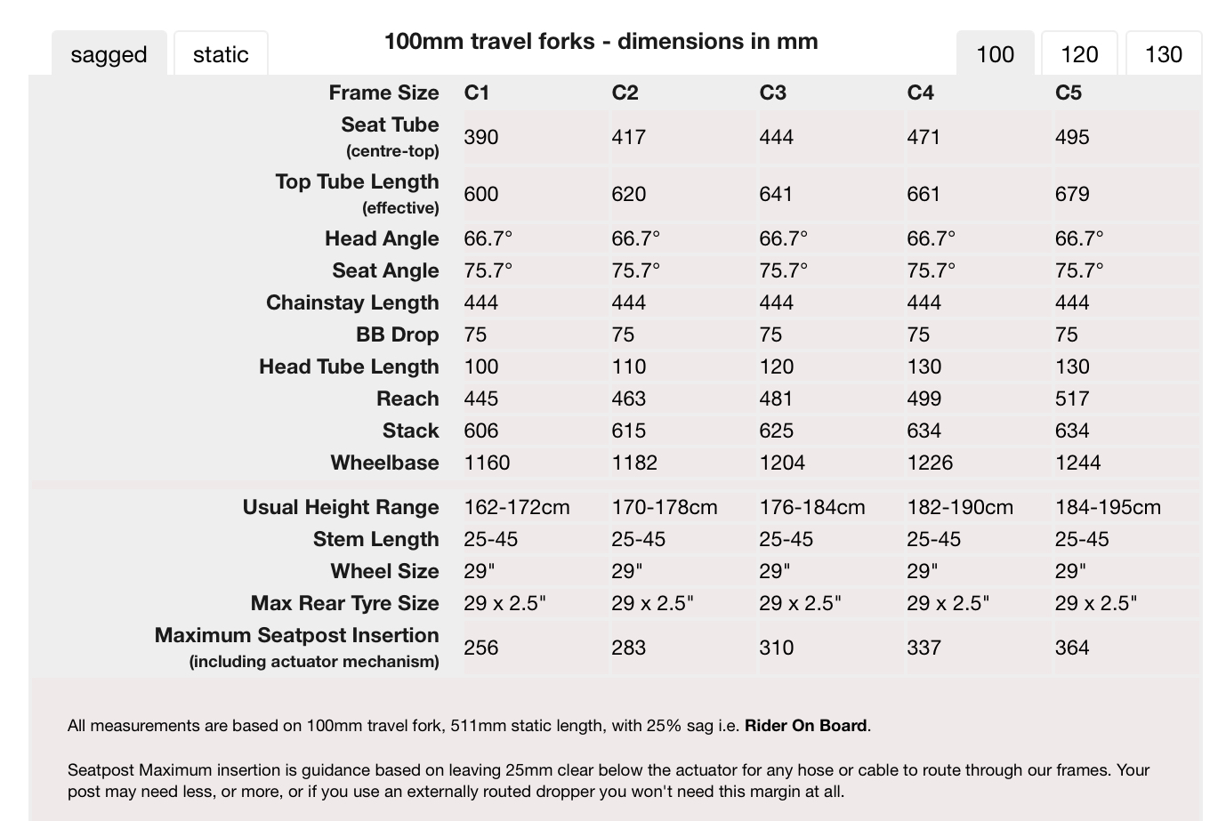

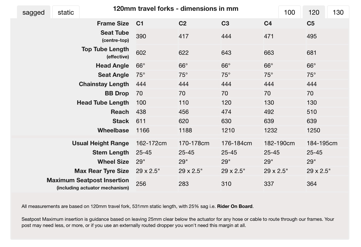

Looking at the Cotic geometry table for the current model with a 100mm fork the figures look remarkedly similar (which was my hope):
Posted : 10/09/2025 12:42 pm
Posts: 4910
If I understand it ( which of course I may not! ) the BB on the newest model would be 10mm lower than the earlier version with a 100mm fork.
Posted : 10/09/2025 12:44 pm

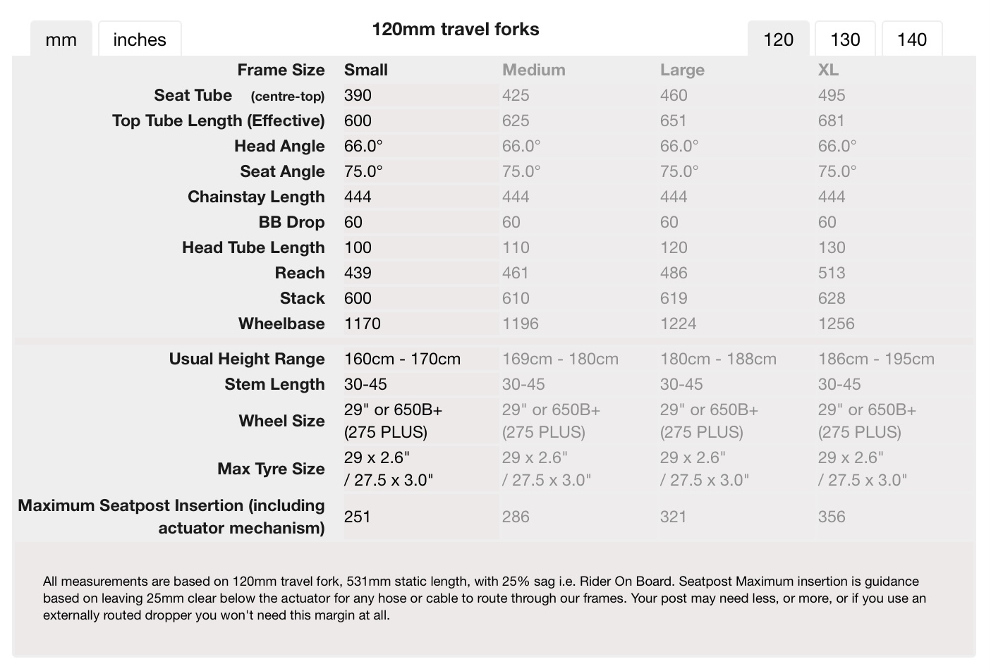

It would seem that there was a further model in between my version and the current version.
This is the geometry chart for mine:
The seat angle is not as steep but the BB drop is the same.
So I’m guessing that a steeper ST may be moar betterer but the HT is shorter reducing stack … further reduced (compared with the 2023 model) due to a shorter (10mm) HT.
Posted : 10/09/2025 2:26 pm

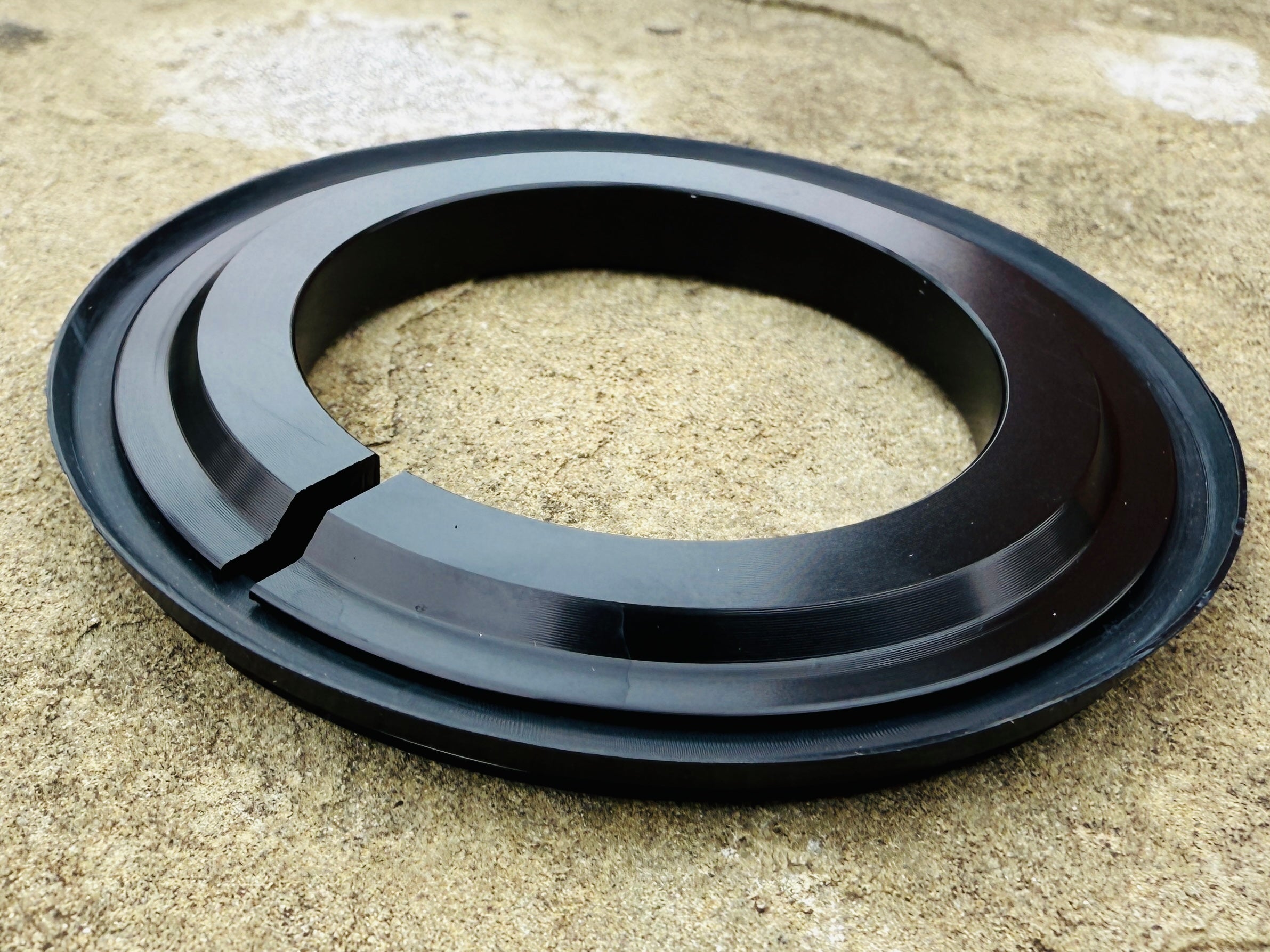

if you want to go halfway, you can add a 100mm fork and a thick crown race like the 10-ish mm https://reverse-components.com/en/products/05%C2%B0-angle-spacer-tapered-forks or the new +5 ones by superstar https://www.superstarcomponents.com/products/headset-crownrace?variant=54595692331393

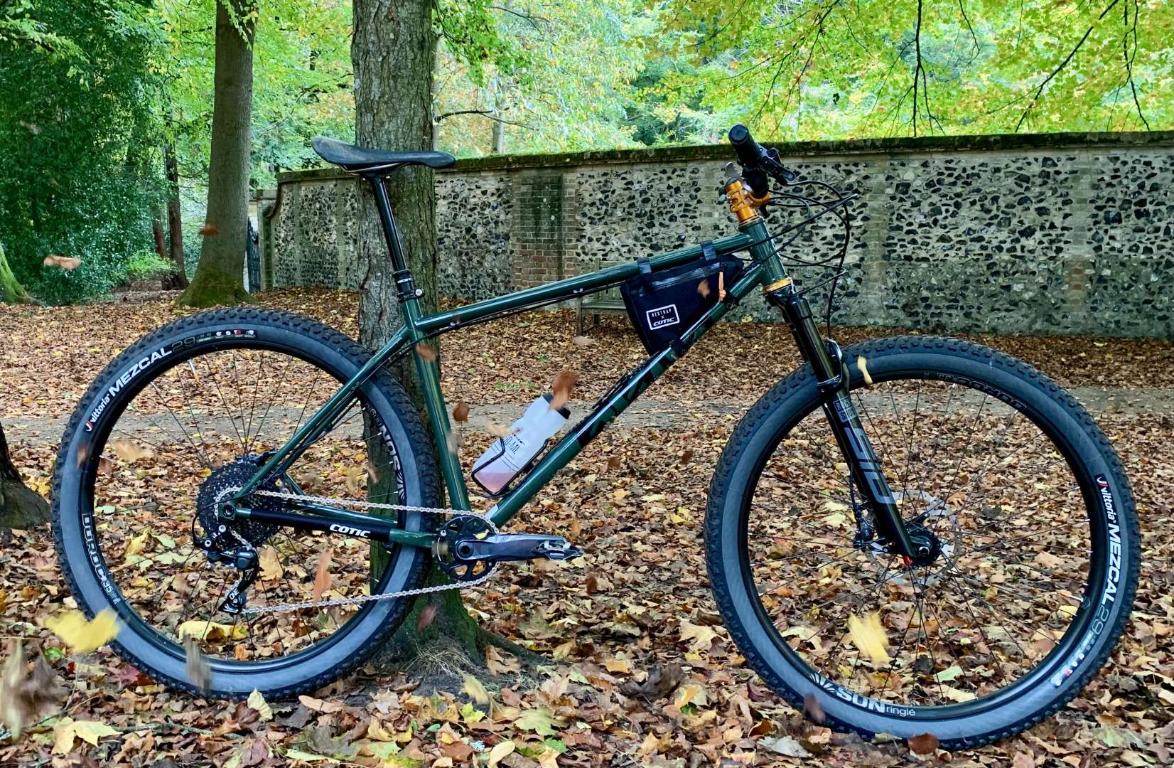

Anyhoo a photo (as that’s what you really want):
Posted : 27/10/2025 11:37 am
Posts: 4910
 IMG_3865.jpeg Or not …
Posted : 27/10/2025 11:40 am
Posts: 4910
Oooh … oooh …
Posted : 27/10/2025 11:45 am
 jfab
Posts: 558
I think I have that same SID in 120mm travel on my Ritchey Hardtail if it's the 'Select' model? I rarely use more than half travel, it sits nice and high but just takes the edge off everything in normal trail/bridleway riding but with some in reserve. I like that the lockout still has a smidge of travel/give so even locked out it doesn't get knocked off line too easily.
The bike looks great too 👍
Posted : 27/10/2025 1:14 pm

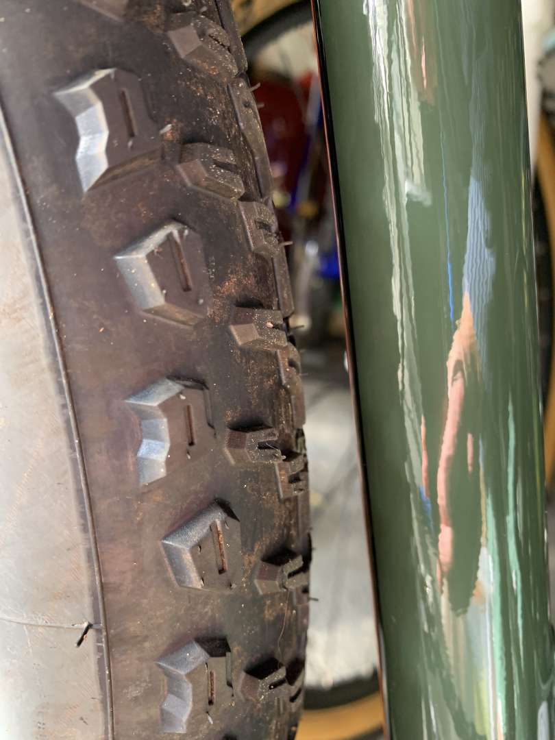

Sweet ride 👍
What size are those tyres though? Rear looks very close to the seat tube.
Posted : 28/10/2025 10:49 am
Posts: 4910
They are 2.6” tyres on 35(?)mm rims.
The photo makes it look a lot tighter than it actually is.
Maybe 12-15mm
Posted : 28/10/2025 10:58 am
