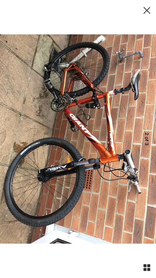

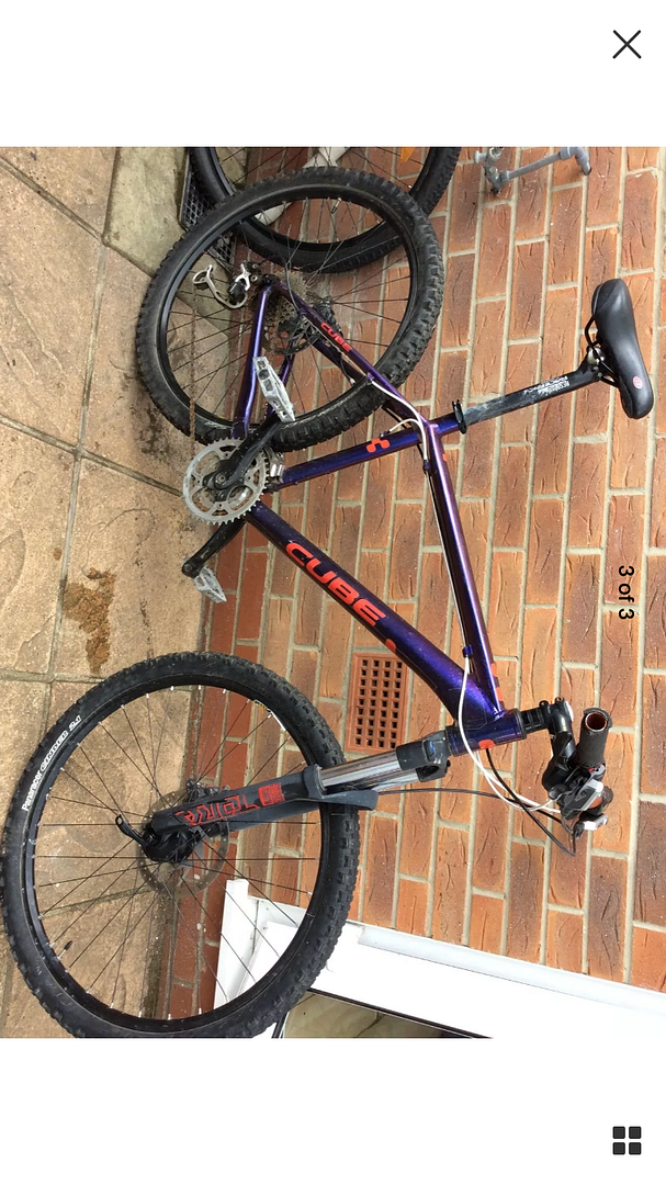

Hi all. It’s been a long time since I was last here but am looking to get back on a bike after a short lived last effort. I’ve just picked up two bikes on eBay which need a small amount of work but I could do with help identifying them.
The first is a giant NRS but I don’t know what year. It’s bearings are all rusted so I need a bearing kit but is it 2000-03 or 04 onwards?
The second is a hardtail cube which was resprayed. Frame number confirms it’s a cube as starts WOW but I don’t n ow what model it is. Any thoughts? Cheers all
Cube
Nrs

I think the cube is a 2010 LTD. bought them both as spares or repair and have a bunch of bits on order to get them running with a view to sell one of them. Question is, which to keep? And what are they worth? I need to see whether the forks are interchangeable but the bits are as follows
Cube Ltd frame set

What would you put on each frame and what would you sell, for how much? What would they both be worth do you reckon? Gotta be 200 quid each?

What’s the cube worth with lx/mph bits? Not a lot I guess. Maybe ride it and if I stick with mtb get a better frame down the line? Just need something to get out on really.

Haven't seen an NRS for a very, very long time. My guess is that frame dates from circa 2003-4 just before the (then) new Maestro platform debuted in 2005 (I think!) with the Reign.
That fork is a Manitou Axel, which is extremely heavy, flexy as hell and by today's standards extremely rudimentary. You'd do well to find a Fox Float or Rockshox Reba (or similar), you'd save yourself a pound and a half in weight.
I have no idea what model of rear shock that is, my guess is that this is an entry level NRS so it is likely to be an own-brand. Again, you'd do well to replace with something like a Monarch RL (which can be found for less than £150).

Make a bitsa so the Cube works and see if you can get £100 for it but be willing to take a bit of a hit.

I have no idea what model of rear shock that is, my guess is that this is an entry level NRS so it is likely to be an own-brand. Again, you’d do well to replace with something like a Monarch RL (which can be found for less than £150).
The NRS was designed to run with zero sag, so a conventional shock won't work properly. The higher end models had a RockShox Sid rear shock that had a separate negative chamber. I think you were supposed to run it without any pressure in the negative chamber. I had a lower spec model that had the NRS branded shock, but no idea who actually made the shock. I ran mine with just a fraction of sag. The Anthem was a big improvement. No point spending money on an NRS unless you feel nostalgic for it and want to show young people how horrible XC bikes used to be.

Much easier to rebuild a knackered hardtail than a knackered suspension bike.

Little update. Turns out they needed more work than originally anticipated!
I’ve swapped some parts over onto the giant but encountered a bunch of issues along the way.
Swapped the forks but the headset was rusted solid. Removed the bearing cages and the bottom one is broken and missing some balls so new cages coming on Friday (£2.49 for a pair, 5/32 1” 1/8)
Seatpost was seized. Destroyed the old one getting it out but got it out without damaging the frame. Hot water, penetrating oil and a 32mm ring spanner as a lever. New raceface post arrived today £10 on eBay. Had to cut off the old seatpost clamp as bolt was rounded off so new QR clamp ordered £3.99
Chainstay bearings are shot and there’s play in the rear triangle. 2x New 6000RS bearings ordered; £4.58 for SKf ones. Can’t find my crank puller though so that’ll have to wait.
SLX brakes bled. They’re ok for now.
SLX front mech fitted. Left the xt mech in the cube so it has some value whilst I try to sell it.
Discs fitted to rims. £2.49 for new disc bolts.
Dropout was snapped. New dropout fitted, £6.49
New chain. £10
Can’t find my brake bleed kit so new syringes and tube ordered £3.49 and need some dot 4 for the cube and the missus so got 500ml for £3.75
New inners and outers for £3.97 with nipples and outer ferrules. Bargain!
Bought a selle Italia x1 saddle for the cube too for £6 but it’s arrived and torn and shite. The dangers of eBay!
All in I’m £54 into it and if I get a decent price for the cube I’ll do bottom bracket for £30, but can’t find my BB tools either so probably another 15 quid in basic tools.
Bought the pair for £120 so if I can get £150 for the cube the NRS will have cost £50!
Cube it’s pretty much ready to go. Just needs the brakes bleeding (for some reason the left level is connected to the front brake so need to swap the hoses around when I bleed them. Who does that, and why?!?!)
Happy to share links for parts of people want cheap bits. Mainly eBay items.
Rick
Posted : 18/06/2019 6:30 pm
Getting frustrated now. Sold the cube for 140 so made back some money but the giant is a pain in the ass to get running. I thought I was nearly there but the SLX front mech is dual pull low mount (top swing) and fouls on the frame weld between the BB and seatpost tube. Need a new front mech.
It was sold spares and repairs and everything was rusted and seized.
I’ve replaced the headset bearings (the old ones were the worst I’ve seen and the bottom had 4 missing!), forks, crown race, replaced the chainstay bearings for SKF 6000RS (awful job without correct tools), then found I had to drill out and replaced the chainstay pivot bolt which was seized and couldn’t get just a pivot bolt so had to make one (another nightmare - ended up with a M8 bolt with shank on it and had 2 spacers made to make the 8mm bolt a 10mm fit for the bearings and the drilled and tapped an internal thread the other side), fitted a used pair of SLX brakes, swapped the wheels, swapped rear mech so is running an xt mech now, new chain, new inners and outers with ferrules and nipples, swapped the shifters, grips, bars, stem, seatpost was seized so that had to be scrapped once removed and replaced with a raceface post, seatpost clamp bolt had to be destroyed to get the seatpost out so new clamp, dropout was snapped so new dropout, front wheel had no disc bolts so new bolts. Think that’s it. Chain tool went missing so had to get another one of those too.
Now I’ve just jumped on it and realised the brakes need a bleed - they seemed ok without any load on them but stick a person in the bike and they don’t stop. Defo bubbles in there too as they do nothing when you turn the bike over and need “pumping” to get any pressure back.
It’s close now. Just ordered shimano fluid and trying to source a mech on the cheap. Fingers crossed I’ll get it together on Saturday and then just set up the shock. Hope that still works...
Grand total for the build currently £62.97. Nice cheap entry back to riding.

Did well to get some money for the Cube! From what I can see the Giant has a front LX vBrake lever!
So I'm guessing you've got Shimano brakes front and rear now? Old Giants I've seen had Giant brakes, which were .dot fluid.

Its got SLX m666 brakes now. The dot 4 fluid was for the mph brakes I transferred onto the cube. I’ll use it to bleed the mrs’ brakes whilst I’m at it as she has Hayes 9s.
Got some shimano mineral on the way for this one. Hoping the shimano fluid, new pads I literally just ordered, and the front mech I just won on eBay turn up Saturday.
New mech is XT M781 dual pull conventional swing. £13 delivered. 2nd hand but good nick.
Pads were £12 a set. Figured I’d try the Noah and Theo ones as they’re cheap but seem to have some reasonable reviews.
Forgot I put panaracer 2.1 and 2.25 tyres on it now too.
Total now £88 or so but worth it all day long I reckon. Xt m771/m781 mechs, SLX m666 brakes etc etc.

@OP - really nice job on that NRS, you clearly know what you're doing and it's safe to say that I'm impressed.
@hols2 - blimey, you learn something new every day! I didn't know that the NRS ran a very unique shock setup like that.

Hardest part was getting the bearings in and out without a workshop or tools. And trying to invent a suitable pivot bolt.
This was my homemade bearing press: a socket, the standoff from a child’s stair gate, the old outer race from the removed bearing and a flat multitool with some nuts either side to tighten it up.
[URL= http://i1092.photobucket.com/albums/i409/vxrick1987/Mobile%20Uploads/9421F81A-9179-42FB-81BE-00A7E7BAA81B.jp g" target="_blank">http://i1092.photobucket.com/albums/i409/vxrick1987/Mobile%20Uploads/9421F81A-9179-42FB-81BE-00A7E7BAA81B.jp g"/> [/IMG][/URL]
[URL= http://i1092.photobucket.com/albums/i409/vxrick1987/Mobile%20Uploads/FECAAFD3-CCE6-4BE1-A2A0-C89AF3754580.jp g" target="_blank">http://i1092.photobucket.com/albums/i409/vxrick1987/Mobile%20Uploads/FECAAFD3-CCE6-4BE1-A2A0-C89AF3754580.jp g"/> [/IMG][/URL]
And this is my homemade pivot bolt and spacers.
[URL= http://i1092.photobucket.com/albums/i409/vxrick1987/Mobile%20Uploads/8CBC61F5-BE59-478F-AFA9-BDDFCFEBD797.jp g" target="_blank">http://i1092.photobucket.com/albums/i409/vxrick1987/Mobile%20Uploads/8CBC61F5-BE59-478F-AFA9-BDDFCFEBD797.jp g"/> [/IMG][/URL]
[URL= http://i1092.photobucket.com/albums/i409/vxrick1987/Mobile%20Uploads/9E837F5B-7F17-4EDA-81F6-BDE14E21DB6B.jp g" target="_blank">http://i1092.photobucket.com/albums/i409/vxrick1987/Mobile%20Uploads/9E837F5B-7F17-4EDA-81F6-BDE14E21DB6B.jp g"/> [/IMG][/URL]
[URL= http://i1092.photobucket.com/albums/i409/vxrick1987/Mobile%20Uploads/9DE7E1F0-3341-4880-ACD6-EF8456DEF070.pn g" target="_blank">http://i1092.photobucket.com/albums/i409/vxrick1987/Mobile%20Uploads/9DE7E1F0-3341-4880-ACD6-EF8456DEF070.pn g"/> [/IMG][/URL]
[URL= http://i1092.photobucket.com/albums/i409/vxrick1987/Mobile%20Uploads/C05A2C6E-0258-4240-BC2B-629811921285.jp g" target="_blank">http://i1092.photobucket.com/albums/i409/vxrick1987/Mobile%20Uploads/C05A2C6E-0258-4240-BC2B-629811921285.jp g"/> [/IMG][/URL]
[URL= http://i1092.photobucket.com/albums/i409/vxrick1987/Mobile%20Uploads/9030AE0F-465B-4826-BCE5-8629AE7877E3.jp g" target="_blank">http://i1092.photobucket.com/albums/i409/vxrick1987/Mobile%20Uploads/9030AE0F-465B-4826-BCE5-8629AE7877E3.jp g"/> [/IMG][/URL]
[URL= http://i1092.photobucket.com/albums/i409/vxrick1987/Mobile%20Uploads/EFFB0893-27A0-4EAC-A03F-122620F89D3C.jp g" target="_blank">http://i1092.photobucket.com/albums/i409/vxrick1987/Mobile%20Uploads/EFFB0893-27A0-4EAC-A03F-122620F89D3C.jp g"/> [/IMG][/URL]
Posted : 03/07/2019 7:35 pm
It’s finally finished.
With the new front mech and brake pads I was up to £88 so I decided to make it the best I could for £100. Found a Tioga MC Groove all mountain saddle which I got for £1.70 plus £3 p+p (bit of padding required as I’ve not ridden for a decade), and some charge sponge grips in white with orange lock-ons both sides and nice end cap cover for £6.95. Found some white flat pedals and a white stem in the garage and I reckon it looks pretty cool.
Total price for this build sits at £99.35 and for that money I reckon I’ve made a bike which will be far more capable than me for at least a year. If I ride it I’ll buy a shiny new one. If I don’t it was less than £100 quid so no great loss.
Better than a £100 Apollo any day!
Full spec as follows:
Giant NRS frame and shock set up for 3.5” travel and almost 0 sag (left a little for comfort).
XT M771 rear mech
XT M781 front mech
SLX M660 hydro brakes freshly bled
Noah and Theo semi metallic pads
180mm front 160mm rear shimano discs
Deore shifters 3x9
Raceface prodigy cranks and BB
KMC chain
SKF chainstay pivot bearings
Raceface seatpost
New seatpost QR clamp
Tioga MC groove saddle
Truvative AKA 80mm stem
Raceface Dues rise bars
Charge Sponge grips
New headset bearings
Cane creek semi integrated headset
Rock Shox Tora forks 100mm travel
Deore hubs on Mavic 117 disc rims
Panaracer Cinder 2.1 front tyre
Panaracer Cinder 2.25 rear tyre
Looks like this
[URL= http://i1092.photobucket.com/albums/i409/vxrick1987/Mobile%20Uploads/4E6CE443-69DA-49E5-9BCD-463355A8FBE6.pn g" target="_blank">http://i1092.photobucket.com/albums/i409/vxrick1987/Mobile%20Uploads/4E6CE443-69DA-49E5-9BCD-463355A8FBE6.pn g"/> [/IMG][/URL]
[URL= http://i1092.photobucket.com/albums/i409/vxrick1987/Mobile%20Uploads/9ED31E77-24CA-4D2F-AFEB-3E9EF59F8FCD.pn g" target="_blank">http://i1092.photobucket.com/albums/i409/vxrick1987/Mobile%20Uploads/9ED31E77-24CA-4D2F-AFEB-3E9EF59F8FCD.pn g"/> [/IMG][/URL]
[URL= http://i1092.photobucket.com/albums/i409/vxrick1987/Mobile%20Uploads/B30C14D5-8F21-4275-BCFE-61F97DA009E2.pn g" target="_blank">http://i1092.photobucket.com/albums/i409/vxrick1987/Mobile%20Uploads/B30C14D5-8F21-4275-BCFE-61F97DA009E2.pn g"/> [/IMG][/URL]
[URL= http://i1092.photobucket.com/albums/i409/vxrick1987/Mobile%20Uploads/91C955E6-2CF5-47EE-ACD8-76A17B279242.pn g" target="_blank">http://i1092.photobucket.com/albums/i409/vxrick1987/Mobile%20Uploads/91C955E6-2CF5-47EE-ACD8-76A17B279242.pn g"/> [/IMG][/URL]
Now to get out and ride!
