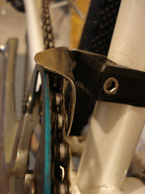

I did the same about a week ago, I've used a BB mounted Stinger (90g) and a modified N-Gear Jumpstop (30g!) with a bash. A lighter replacement for the Stinger would reduce that further.
Not mine, but this is what I copied:
On a Hone bash the jump-stop doesn't hang over the edge and looks tidier.
You simply email N-Gear and ask for the right size, he sends it to you....then you pay! If you don't like it, return it with no payment. It took about 9 days to arrive from TX, I didn't get any email response just the packet in the mail.
Make sure the jump-stop is as close fitting as possible in your lowest gear (it will need to point towards the rear hub slightly due to the chainline in biggest cog) and get it low to the bash. Quite easy to fit and doesn't clog with mud anywhere near as much as a mech as there's less going on.
I am finding it a little hard work on the climbs though 😳 But mechanically it's functioning great despite some purposefully clumsy landings on my Blue Pig X.
