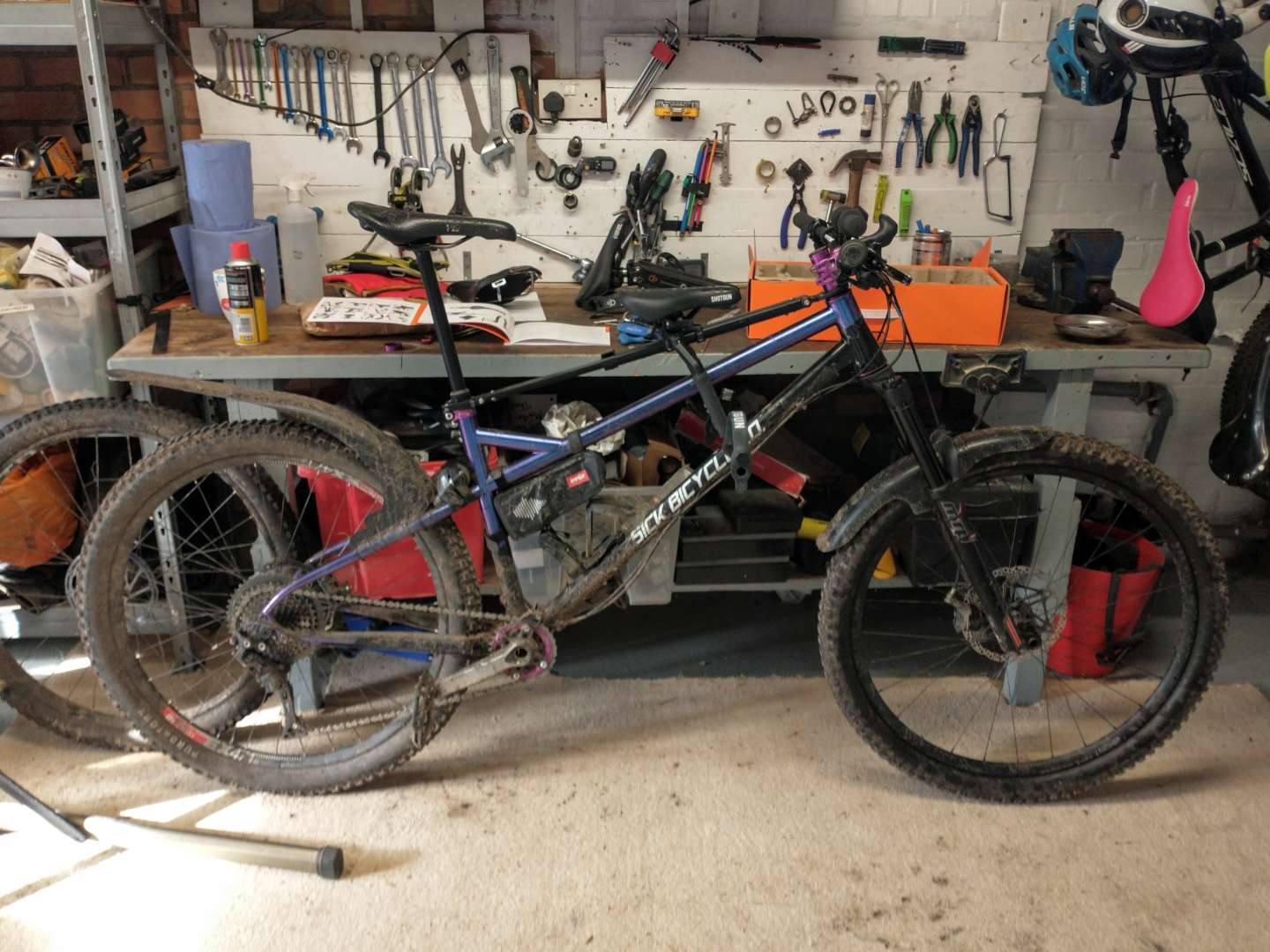

Currently I ride a 160/135mm geometron G13 full suss and 160mm hardtail. IMG_20230209_211058819_HDR.jpgimage.jpg
I'm thinking about swapping the ( not ridden much) hardtail for a 170/ 170mm bike.
