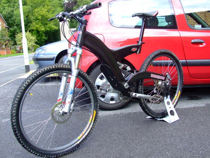

Just bought a set of 2006 Fox F90 Rl's from the 'bay. Thinking that along with the snazzy new forks I'll be needing some slightly larger rotors for my juicey 5's. Problem is- I don't know how large I can go on the fork.
This is what they look like for reference:
Ideally I wanted to go for a 203mm rotor as I'm not really that weight conscious.
Can anyone help me as I really don't want to buy things that won't fit!

You can fit any size of rotor you want and will have no problems with the fit, however fox advise not to go any larger than 180mm on pre 2007 32mm forks. the fork crown is not as strong as on later models.
I
Posted : 29/07/2009 9:51 pm
Great- thanks for the info. I did not know that it was down to what the fork crown could take. 185's it is then!
