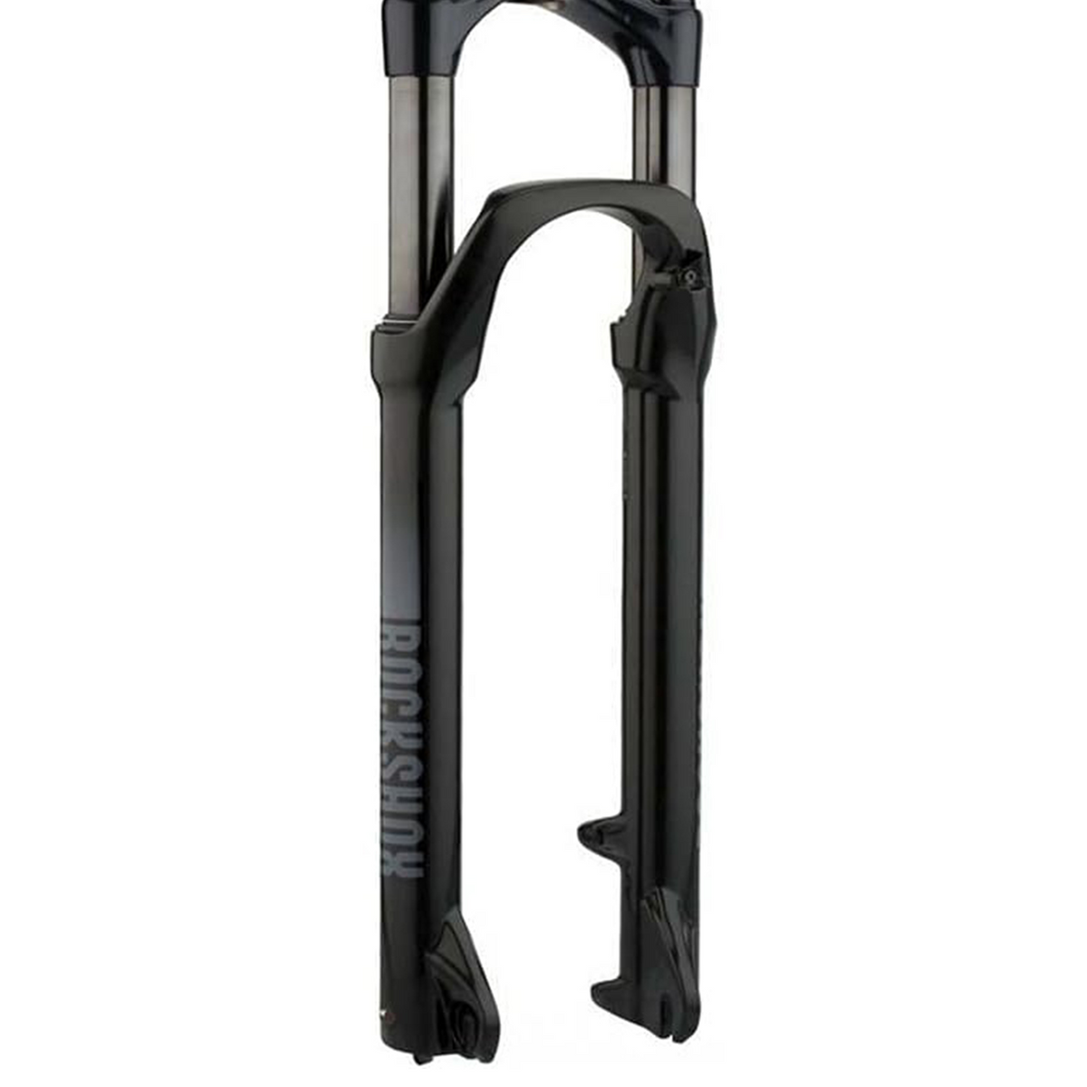

Requirement for QR is going to massively limit what is available to you... It's basically "budget low end" or a 2nd hand fork that's 10yrs+ old...
The "best" fork I know of available aftermarket right now with a QR axle is Rockshox's entry level Judy TK (even then you'll have to look to find one as most of them are through axle)... https://sportandleisure.com/products/rockshox-judy-silver-tk-29-qr-straight-steerer-mtb-fork-remote-lockout
A change to a "Boost" (110x15mm) thru axle hub will open up your options massively...
