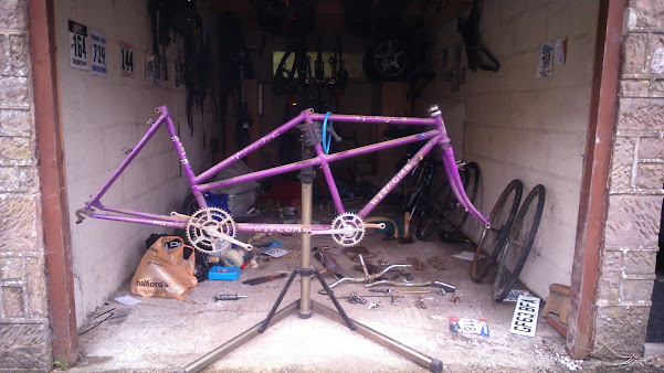

Progress is going pretty well given that I got shipped to London for the last two days for work.
I've rubbed down and started shining up the major components, which I knew would be the most time consuming bit.
[img] https://lh3.googleusercontent.com/QlXdbvBYwL9JabJXrc4dedYJiWfwDJn1Pf5eTUyl74Zn=w558-h900-no [/img]
The smaller components are being treated to some Hammerite rust remover gel, which is essentially flubber.

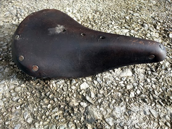

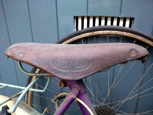

I have also gone about polishing the frame and restoring the saddles.
[img] https://lh3.googleusercontent.com/ecDo4Doa2MiKNFnet9PjxEKgt_MHrv0JtwTA5-AdXc7Q=w558-h900-no [/img]

I have used every detailing product I have on the frame. The paint is a bit too shot for it to look good but it is much improved.
[img] https://lh3.googleusercontent.com/_kLcQUV40LNR6UQGtQZccuSwmqlDQQDT2p2imGhiMIIW=w558-h909-no [/img]
[img] https://lh3.googleusercontent.com/EAOVrbZ6YU_-3UYgI8MjlHhrfSsE_t6Xa1NFKi17zdbB=w432-h999-no [/img]
Here are the BB photos.
[img] https://lh3.googleusercontent.com/Yr7bOP_wHyqlT-lkvlG9FKqeStZ-mXvuuFUgpgoPu97e=w540-h999-no [/img]
[img] https://lh3.googleusercontent.com/XN0Kp3xUV2h_oOE7BAlpNMcZvs1Y-kXts9dhsZ5l622t=w744-h999-no [/img]
And the first part to go back on, the rear mech.
[img] https://lh3.googleusercontent.com/R1uwdX0CmG2bs3yoGYfwuoH6NUAbgUFtwS0bLklldiZE=w540-h999-no [/img]

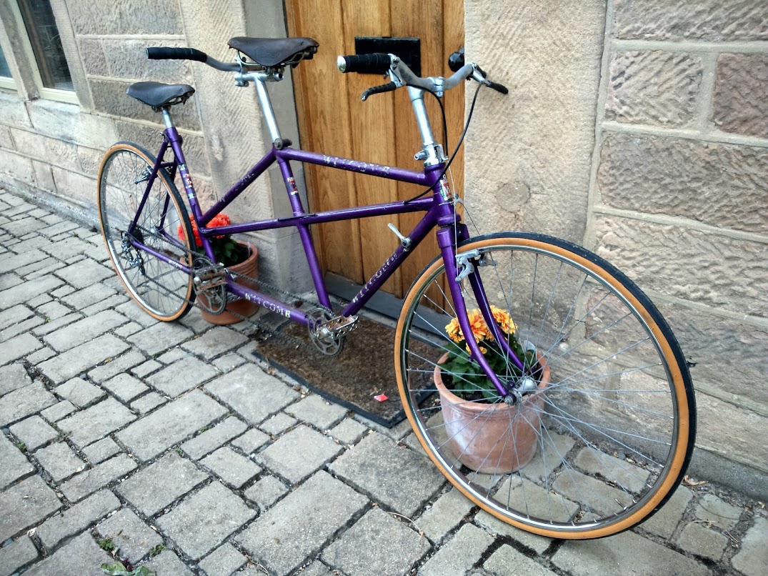

And here we go! Taken it for a spin and the ride is definitely interesting- braking has to be planned a long way ahead and the position is bizarre- very tall and very short. Gearing is also lacking but manageable with two people's grunt. Everything has been checked and re-checked for tightness and not-falling-offability and it seems good.

Okay, the opportunity has arisen to get this repainted and dismantling starts tonight.
I'm mulling over whether or not to paint it in the original colour or go for something different - a powder blue, maybe black or something. What do you reckon? I quite like the original colour but it'd not be my choice and it's not like repainting a classic car or something where it's of high value which is retained by keeping it all original.

I forgot to update this. The best man from my wedding got married in September. They were going to get two vintage bikes but then saw I was doing up the tandem and offered to go halves on a repaint and new decals. And so we got to this stage-
It went down a storm! I'm tempted to hire it out for weddings...
We use it for picnics with the rack, for popping to the shops (though the gear is way too steep for the hill back to our house) and tootling along railway lines.
