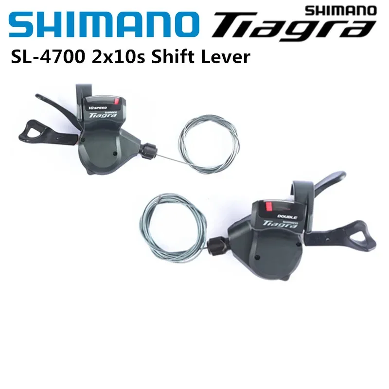

I think that it's Tiagra 4700 flat bar shifters you'd be after (perhaps someone can confirm). They seem quite pricey new (around £100 a pair) & eBay prices are highish also.
They were pricey when I look at them a while back (they'll work with GRX400 2x10 and I was toying with the idea of putting a flat bar on my gravel bike).
You could try a Wanted add in the classifieds here in case anyone has a set laying around.
Be careful buying though as it looks like there are 3x10 versions too.
Aliexpress seem to have them really cheap but I've never bought from them and I've no idea if they'd be genuine.
https://www.aliexpress.com/item/1005008541501028.html
Posted : 17/05/2026 4:46 pm
Posts: 2748
Well, yes, I've only bought a couple of small items off Aliexpress, but today have splashed out £23 for a pair of 10 sp Tiagra shifters. Whether they are genuine is another thing. 3 x 10 would be fine anyway, just use the stop screws to limit the front movement. If it comes to it, I could just fit a MTB rear mech, and use a suitable shifter, but then I'd be tempted to go 1x, and suddenly the price has gone up well over £100 for what is, in effect, a less than £100 bike.
it is worth being certain, 4600 and earlier will be old “2:1” cable pull, 4700 would be new road pull ~1.4:1 not cross compatible with MTB dynasis.
There were flat bar shifters for both flavours of cable pull. You might be better off going for a more recent bargain group Advent(X), CUES or just 2nd hand bits of ebay?
