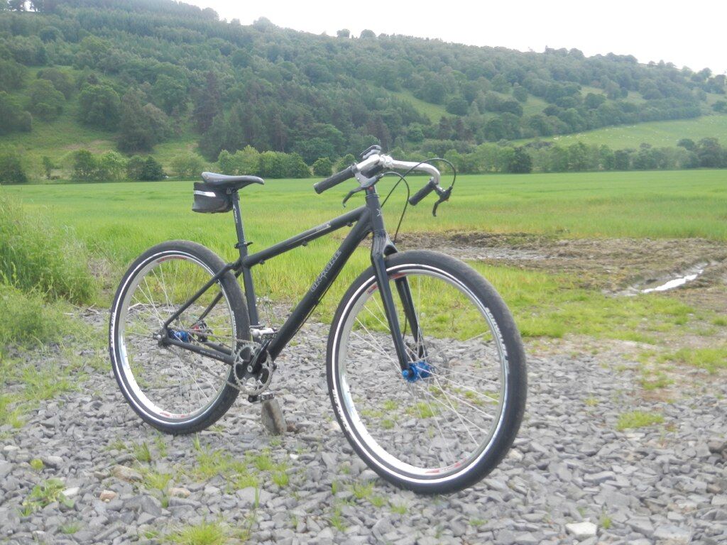

Posts: 3297
My two bikes both fill your brief perfectly in slightly different ways.
A 26" monstercross built up around an old Rockhopper frame I bought off here for £25 (I ran it for two years as a rigid MTB but prefer it in its current drop bar guise).
A 29" Sonder Frontier based on a frame bought new from their eBay outlet last year for £159.
So, buy second hand, and/or keep an eye on this eBay store.
EDIT: I prefer the slightly old skool geometry of the Frontier to the V.3 Inbred it replaced for my (effectively your) purposes.
Posted : 09/08/2026 10:55 pm
