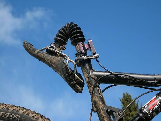

The OG Gravity Droppers were deemed to be just fine and they only had two positions. Some folk did modify (drill) them for an in-between option.

The original dropper post was the GravityDropper, which came in 3" and 4" versions. Initially fully up or fully down, but later they also had a 1" drop setting (they were mechanical and locked by a pin in a hole in the post, so were limited to wherever those holes were drilled.)
They were much better than a fixed post, but having infinite adjustment is much better. I have mine fully up for road climbs, about an inch down for pedaling on the flat, down about 4" for easy descents, and down 6" for steep descents. I cannot understand the fully up or down idea.

the 3 point gravity dropper was great and pretty close to how I use infinite position droppers now
all the way or all the way down isnt ideal but it probably covers 95% of my dropper post use and its absolutely better than  just a QR seat collar!

Drilling an extra hole in the inner post turned out to be a weak point.
