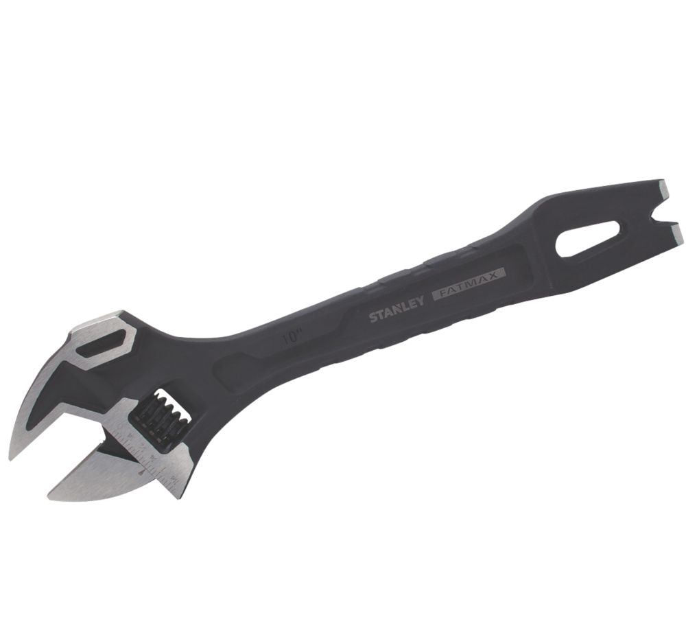

Edit, it doesn't do the bigger lower headset one however a plastic tyre lever, mallet shaft and a big adjustable spanner to whack it with works

Edit, it doesn’t do the bigger lower headset one however a plastic tyre lever, mallet shaft and a big adjustable spanner to whack it with works
That is just wrong on every level! But I love it! 🙂
Posted : 04/02/2021 5:14 pm
Posts: 9995
Thanks, every tool box should have a demolition wrench
