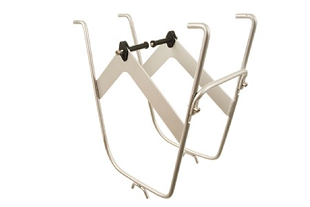

i was thinking about this today. the GF wants to do a little bike touring next year. i'll have the BOB and she'll have panniers, but her Sanderson HT hasn't got the necessaries to fit a normal rack.
and today i saw this (her old man already has one):
[img] ?osCsid=71dc7e6d25159989598fcc9827a2382f[/img]
which combined with these:
gives you this:
Posted : 19/12/2011 7:42 pm

without wanting to sound rude, what's the point of that? And how does it fix on at the bottom? No doubt it suits your purposes, but the bike i get will have rack bosses

Posts: 13542
no worries...
but it suits me fine. niether of my hardtails (read gears) have rack bosses/mounting points.
good luck with your search...

Posts: 2238
Alpin - word of caution on the weight... I managed to snap one of those side mounts (so not the rack; just the supports that allow it to carry panniers) by over loading it and then swinging it around while riding off road. Entirely my fault but when packing worth putting light bulkier stuff nearer the bottom of the pannier and heavier stuff near the support.

Posts: 13542
more info please TJ..
ghe one thing i like about the Topeak and BOB is that withing seconds you can remove all touring paraphernalia and take your bike onto the trails....

alpin - that would be a good solution, until you load it up with any significant weight. 😆
Posted : 19/12/2011 10:02 pm
