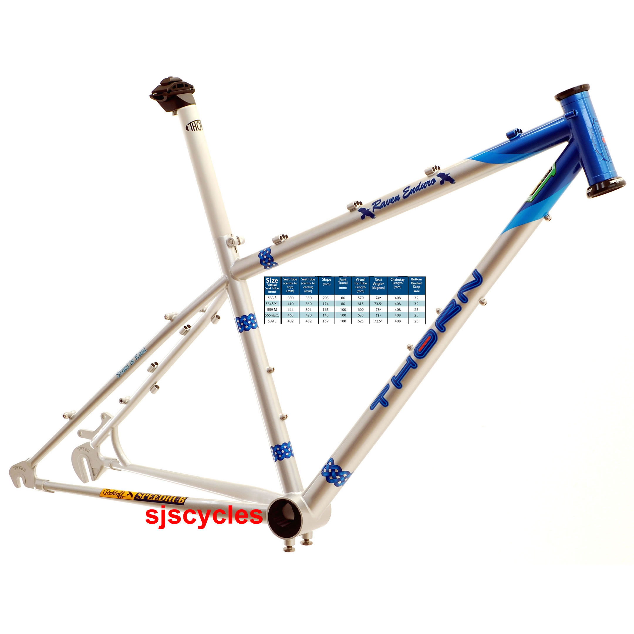

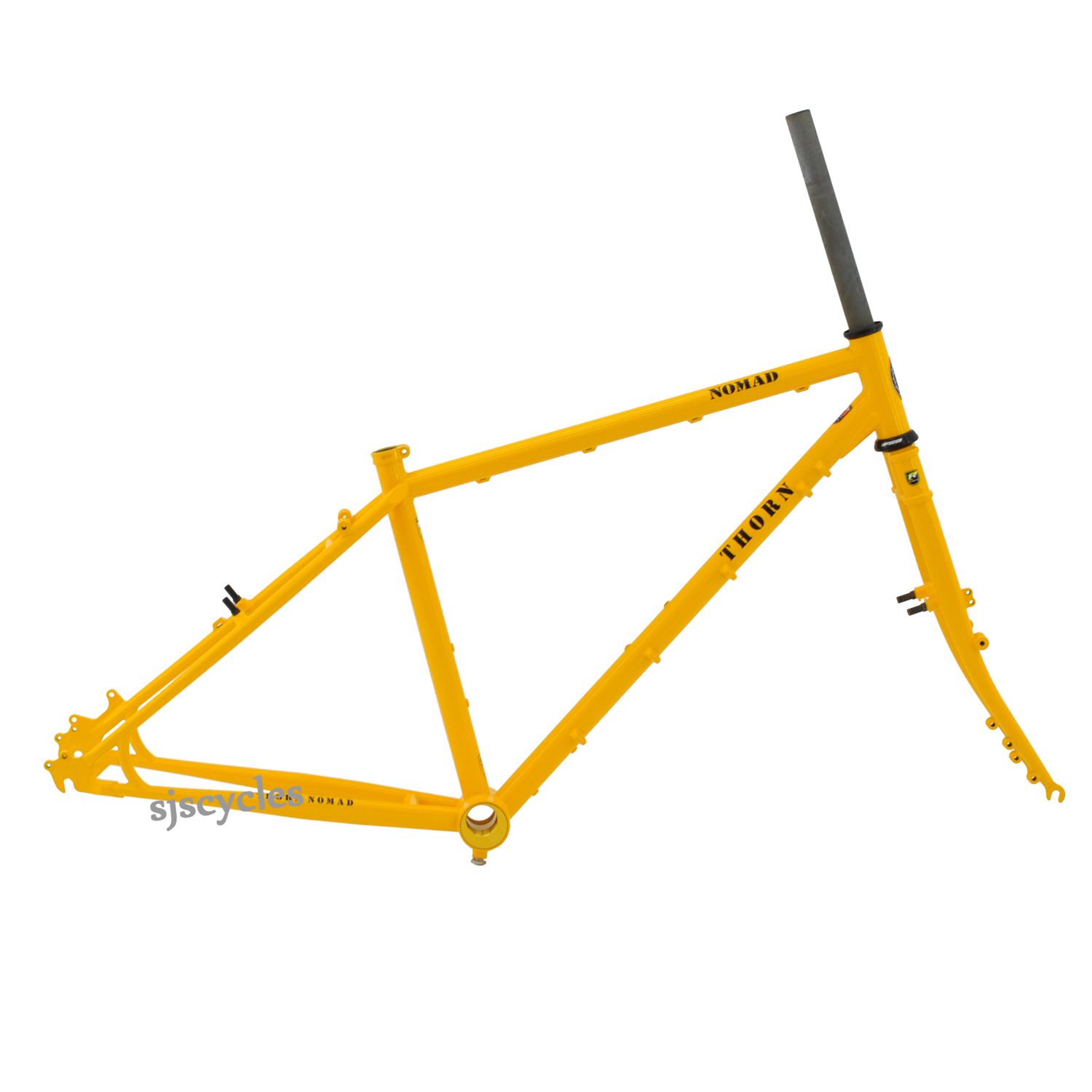

Thorn raven or nomad boblo.
website's a bit Sheldon-esque, but theres plenty of pdf material to read up
http://www.thorncycles.co.uk/models.html
or SJS
http://www.sjscycles.co.uk/thorn-shopthorn_pg1/
Raven
Nomad
Posted : 02/10/2011 8:23 am
