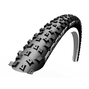

Um, I did the 3 Peaks yesterday with 70 psi, I normally ride with 75. It's never going to be an armchair comfortable ride at any pace on a CX bike.
I normally use these;
But opted for a grippier front;
Pump them up and get cracking!
