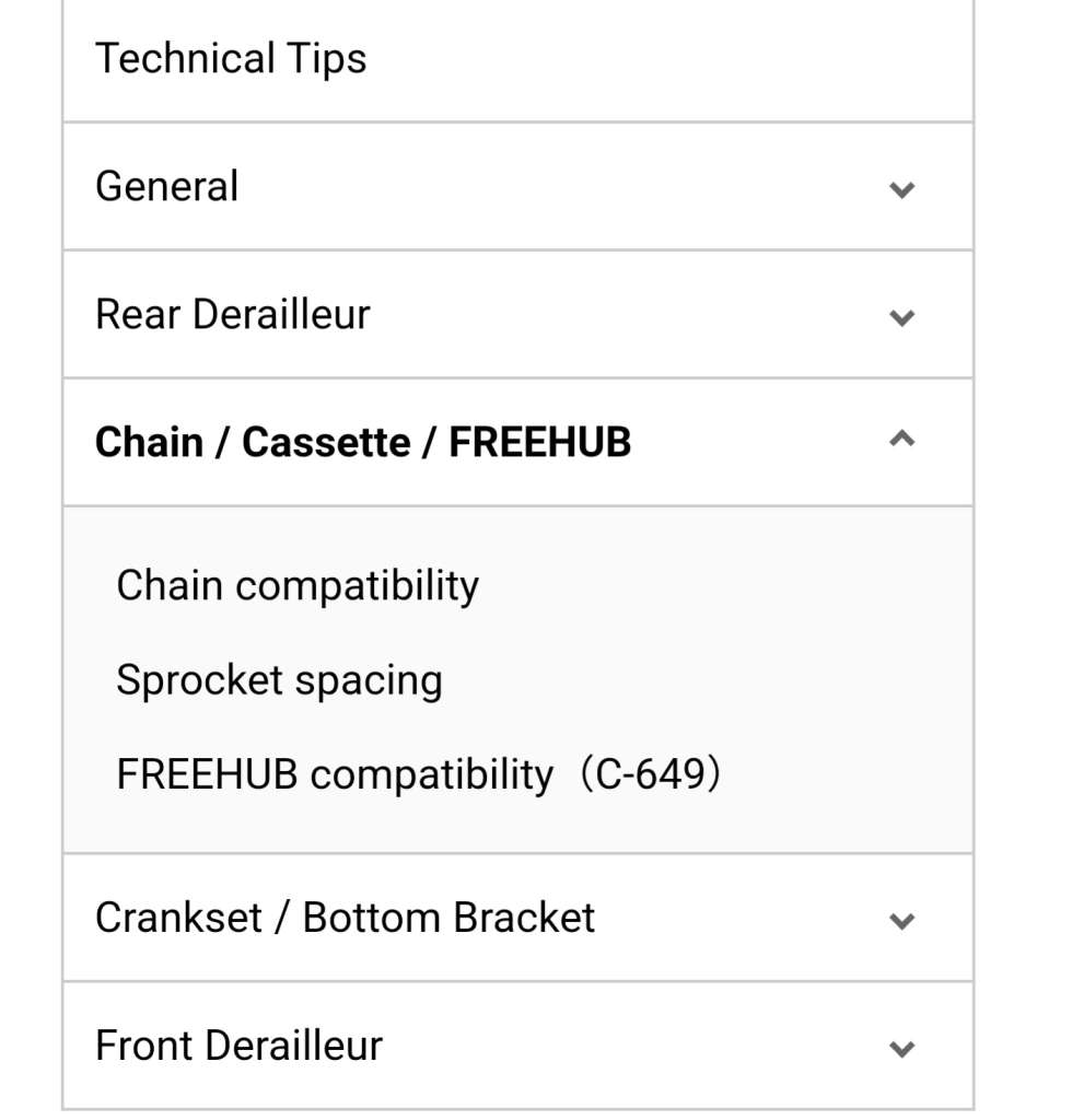

Yeah, that's really hard to find too 🤷‍♂️
https://si.shimano.com/en/cues/technical-assets-tips
Screenshot_20231202_145613_Chrome

Seeing as I can't find it, perhaps you could screenshot it so I can verify the 4.15mm I measured.

Is that 5.25mm dim meant to be the spacing? I thought they were trying to illustrate something to do with spoke clearance on the 11 speed overlapped sprocket, bit it could be the relevant number...

Still waiting on Simonbarnes to screenshot where he saw the definite measurement on the Shimano site ..
Sorry, I thought the link in my screenshot above that said sprocket spacing went to a diagram that had the sprocket spacing - apparently it didn't.
