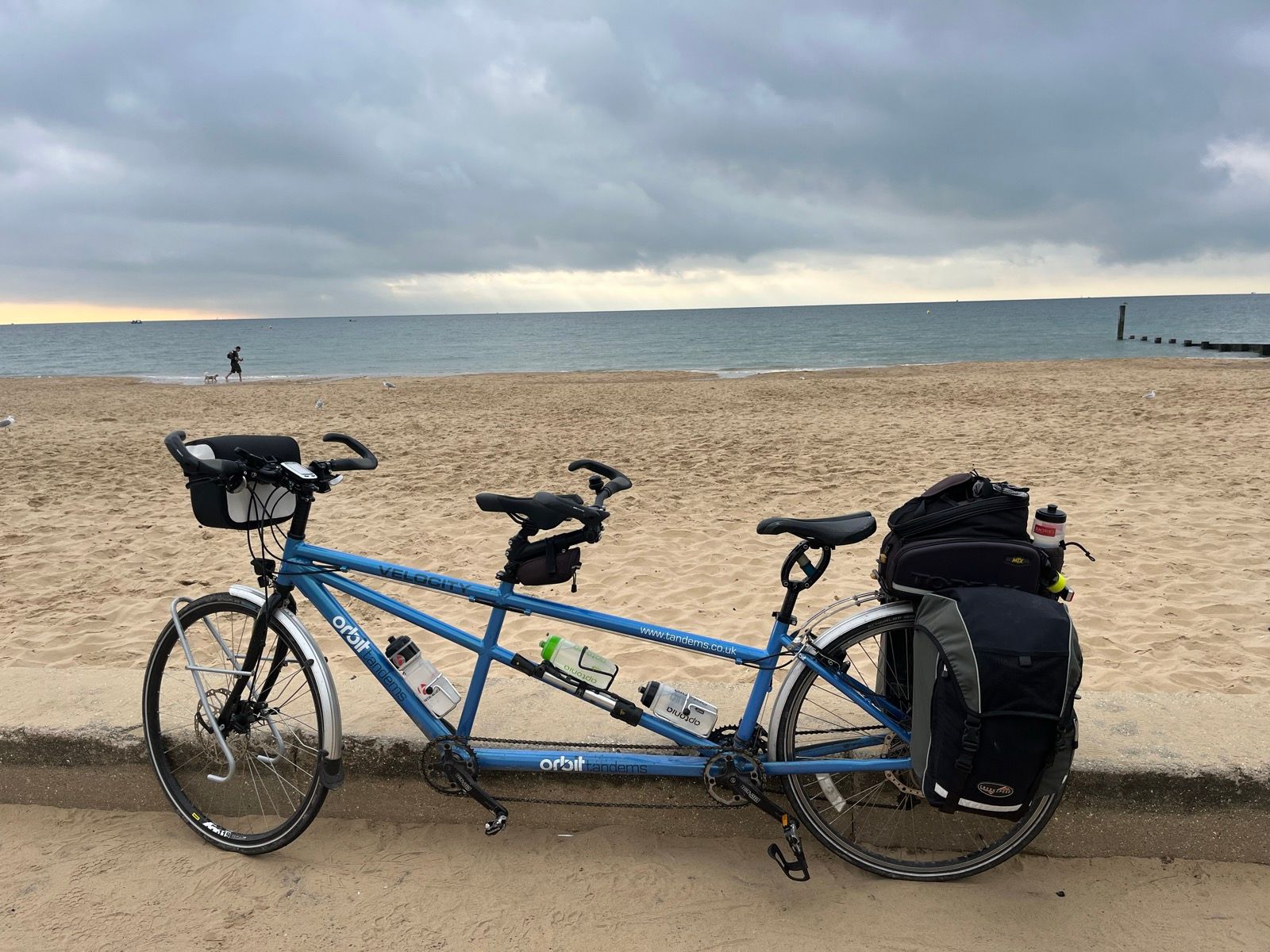

Mrs NBT is very keen to ride Lon Las Cymru, and we'll likely do it in the same way we've done pervious trips - this is from the latest one, a week's loop  around Normandy / Brittany and the south coast of England
Tandem with bar bag, rack pack and two panniers
We've done several trips with this setup

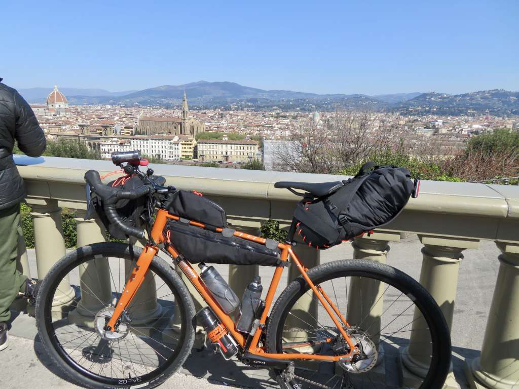

I have bike packed with a variety of set ups: seat pack, panniers and Tailfin Aeropack (the best but expensive) on the rear and bar bag and fork bags at the rear.
IMG_1352IMG_5115IMG_2946IMG_4594
For the trip you are proposing I’d opt for a saddle pack, bar bag, fuel cell and maybe a small or medium frame bag. That set up will allow you to spread the load nicely and have easy access to everything.
As @scaled say above the Podsac bags from Planet X are good quality and great value for money.

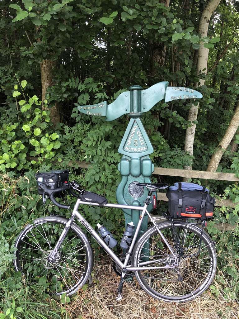

This one shows everything I used for a 3-day ride across the South Downs Way.
Podsac seat pack with cooker, change of clothes and light jacket (Probably ¾ full). Blackburn Outpost HB Roll with tent, sleeping mat and quilt. Restrap top tube bag with tools, spare tube, spare hanger and power bank. Restrap stem bag with snacks.
Replace the HB Roll with a small bar bag or frame bag and should easily fit everything you need for your trip.

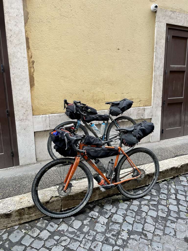

We did 10 days through Italy last year with the setups below. Staying in air BnBs.
We started with alpkit bags some 10yrs ago, but have moved to restrap. The restrap are more secure and are nicer made IMO.
