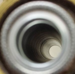

Took the wheel off initially to check for damage to the alloy freehub, not too bad there Im glad to say but looking down the bore of the axle there is a definite radial line around half way down. Cant help but think if it isnt a crack in the axle yet.... it will be a crack/ breakage in the future... Im not a light rider at between 15/ 16 stone depending on pie intake!

FWIW the solid skewers don't fix the problem- both the axles I snapped were on a solid skewer, on 2 different bikes.
I do have 2 used and un-cracked axles if you want to go for the cheap and easy "have some spares in the car" approach... The bike was still limp-home-able when I snapped mine. Hope will sell you the bits to upgrade to Evo spec but they wouldn't even offer me a discount on RRP which to be honest I thought was shit- they had to send me a replacement part anyway on warranty but wouldn't even knock the value of that off 🙁

When mine snapped, I didn't even realise till I took the back wheel out & my cassette rolled across the floor!
Hope fixed it and as Northwind says, I have a spare in the van, although it's not something you can fix trail side.
