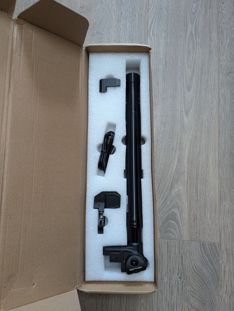

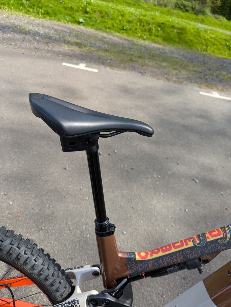

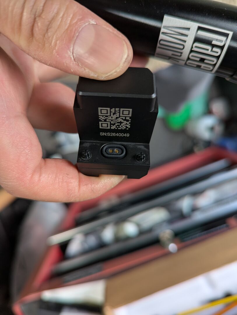

Well, it has turned up and had my first outing on Friday.
1st issue is the stack for the saddle is high due to where the battery / electronics is. It's roughly 15mm more than the Limotech dropper post that I had. So it had to be fully slammed down but still ended up 2mm higher than my old post at full extension. Not something I can notice but it was very close to it not working for me.
2nd issue is a big one which is the wireless connection. It's completely stupid that the remote forgets the seatpost every time you take the seat post battery out to charge. To pair, the method is to wake up the post using the actuate button on the post side, then keep pressing the actuate button on the remote for up to 1 minute before they pair. It took 10 or so presses before they pair. I can imagine if more than 1 of us have the same post in a group ride, that would cause absolute chaos. Also unsure what would happen if you have more than 1 of these posts / remotes in range, I can't test that obviously.
3rd issue is more with my frame, whoever built my bike decided to use the space between the bottom of the seatpost and the motor as a space to hide cables, in a proper rats nest fashion, so I had to drop the motor, tidy it all up and find a new space to hide them before I can put the seat post in the right position. The advantage of it fully slammed is the "race work" logo is not visible, it's even in the same place as a Reverb.
Other than that, it works great. It sounds a bit agricultural but it reacts to the button press instantly and the post comes up at a fast speed, just like a freshly serviced Reverb except there is no lever throw before the post activates which to me is the biggest improvement in use. It also surprised me how much extra 25mm of drop helped.
Weight wise measuring full system weights (i.e including cable / remote), the post is 771.5g vs 768g declared. Compared to my 150mm Reverb at 620.4g and Limotec 656.1g, I think roughly 150g for extra 25mm travel and electronic activation is pretty good.
My only other worry is potential water ingress, the seals look OK but only time will tell.
