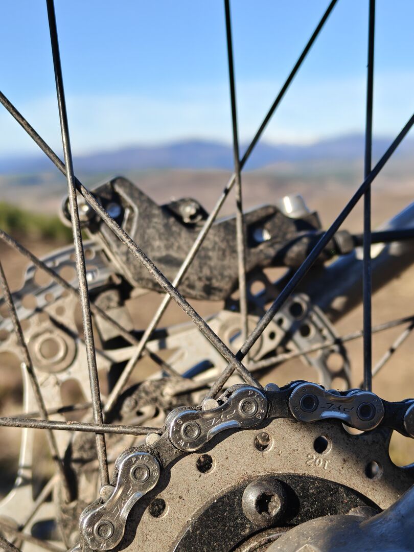

I'm just using these Gusset SS cogs on my Moxie - they're fine!
https://www.biketart.com/products/gusset-doublesix-ss-sprocket
Had 1 chain drop in the last 990km / 5 months (and that was only because there wasn't enough tension in the chain).
I'm running cheap SRAM 9sp chains, and a VeloSolo Aluminium SS chainring.
Posted : 29/04/2026 4:32 pm

Looks to be inside 2mm thickness at the base of the tooth. It fits a XT 12sp chain fine.

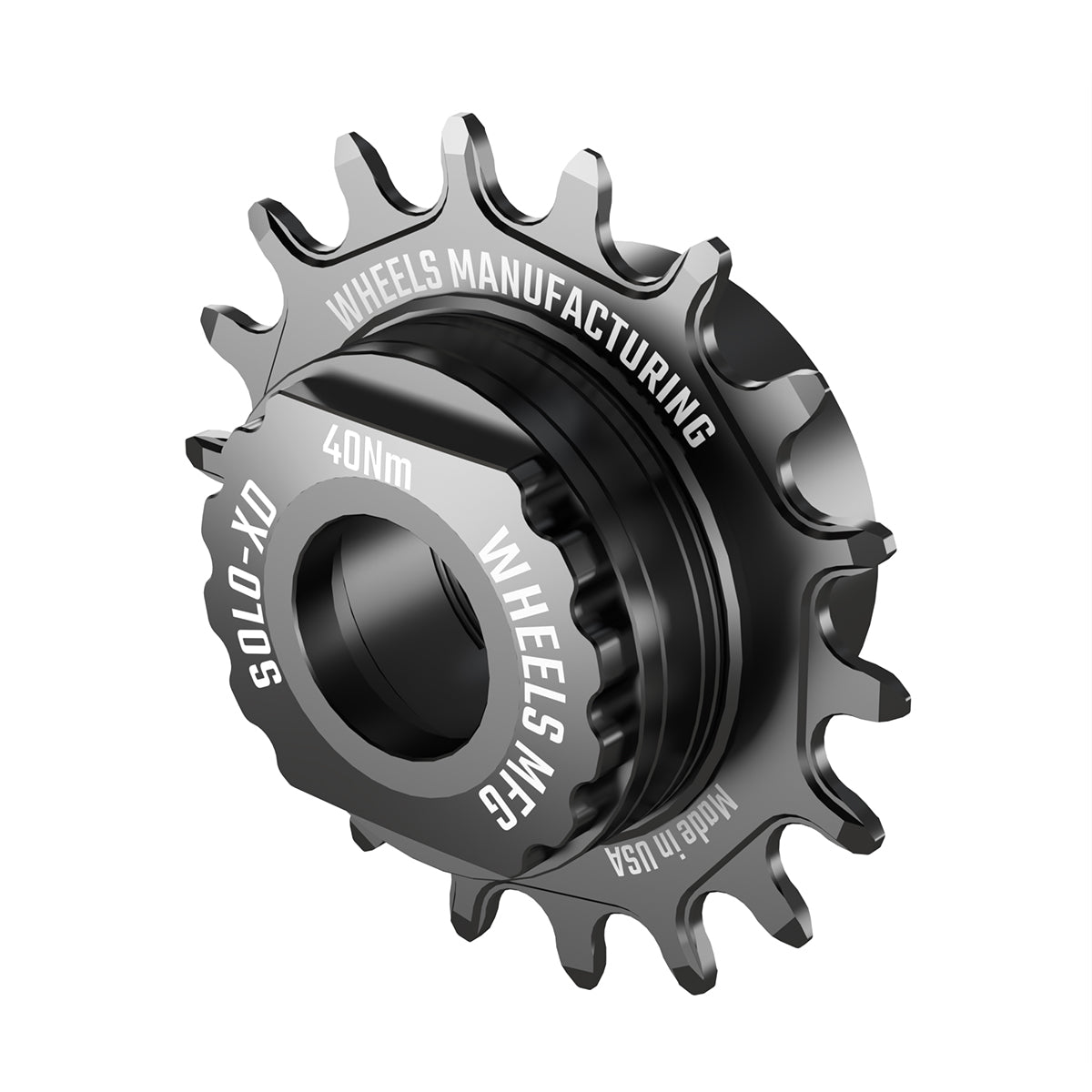

If you do decide to go hyperglide freehub then these AbsoluteBLACK Single Speed NarrowWide Sprockets are good (although unfortunately 18t is out of stock).
