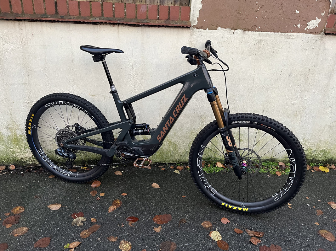

Carbon rims (Sixth Element) on the big bike, alu everywhere else. Love the carbon rims, love not having to true or worry about dings etc. That said, I did case a gap straight onto a sharp edge and cracked a rear (miraculously the tubeless stayed up and carried ion riding it for a week or so...) However, it was a heavy impact and I wasn't riding any inserts. Rim replaced for free (no quibble warranty) and back riding within a few days. Now with insert and no issues since. Have done the same with Alu in the past. Given the lack of maintenance required between I'd def recommend carbon.

I'm on a set of eThirteen TRS carbon wheels which came on a complete build and have been almost completely fine for the last 2 and a bit years. One broken spoke and one warrantied hub axle (quickly replaced) in that whole time and they've stayed nice and true.
All that said, if they needed replacing I'd be getting a set of alloy Newmens. Their listed weight is about the same, they have fantastic reviews and they cost far less plus they have a nice quiet freehub which appeals to me.

NEXTIE
Holy thread resurrection! I've been a huge carbon rim fan for years now and now a good friend has started to import NEXTIE rims and wheel sets in the UK - it was only a matter of time. We weighed the above at 1570grams for the pair, nearly a 1kg saving on the OEM wheels! The ride feel is transformative, he's planning on offering these for circa £750, for the money I'm pleased to say the least!
Posted : 29/11/2022 8:28 pm
