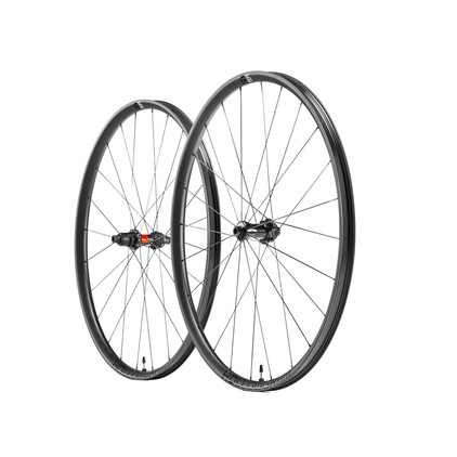

I thought these were a good price, but only 650b... then I saw the weight! 14.5kg! 😆
. https://www.sigmasports.com/item/Cannondale/HollowGram-G-25-Gravel-Wheelset/10LHR
Posted : 14/03/2025 1:07 pm
Posts: 11808
Posted by: desperatebicycle
Haha, clearly cheap OEM wheels being sold aftermarket, they always say stock wheels are heavy 😆
