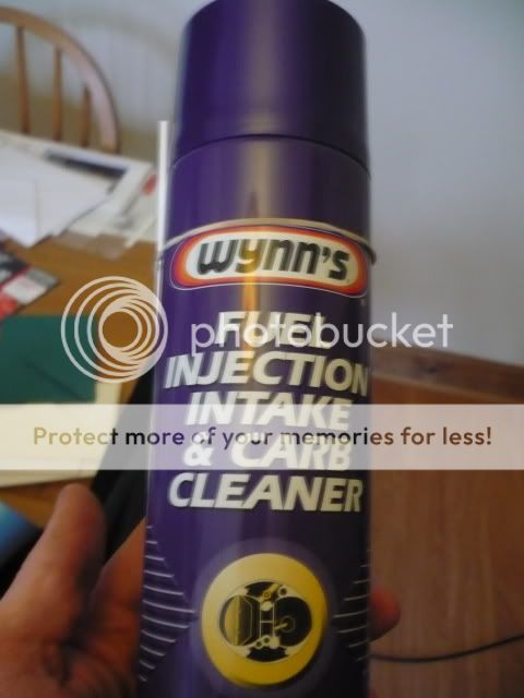

Has anyone ever used carb cleaner on their bike?
My commute bike has been used and abused in all weather, never really washed and only rarely oiled. Its drivetrain is covered in a horrible, previously-impenetrable road grime that was resistant to all previous attempts to clean. I'd tried the usual Muc Off / Fenwicks / Citrus degreaser and scrubbed with no effect. In a fit of despair over the state of it, I searched the garage for something stronger, and I found a can of carb cleaner and sprayed that on. Lo and behold, silver sprockets emerged almost immediately from underneath the brown rusty grime.
I got some on my skin and it left me with a burning sensation for several hours. So you [i]know[/i] it's good stuff. Anyway, I just thought I'd share my discovery. Unless someone can tell me why it's a terrible idea to use this stuff, I shall be using it more to clean the un-cleanable. 8)

Just use white spirit. Vastly cheaper and just as effective. You don't need anything quite so aggressive.

Assuming that's the same kind of stuff as brake and clutch cleaner... amazing stuff! Buy it from the local motor factor - about a tenner for five litres.

I used some carb cleaner to un-gunge the carb from the leaf blower recently. I stood the carb in a plastic bowl to catch the run-off. It dissolved the plastic bowl. Wouldn't let it anywhere near my bike.

just do not expose the remains to heat/flame or weld.
google phosgene gas.
What more proof do you need? Awesome.
I had tried many less aggressive options, none of which worked. More aggressive = less scrubbing. Ideal.
Besides, the carb cleaner comes in a high pressure squirty bottle and really blasts the grime off.

Really ****s your seals up too, awesome! You listed a load of crap marketing hyped products which work as general detergents, but are shit at actually cleaning or degreasing.

Must admit I've only ever used brake and clutch cleaner to clean chains, cassettes, chainrings and components when off the bike - I'd never let it get anywhere near the paint or my carbon bikes!
