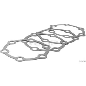

A shim behind the rotor will move the disc towards the caliper.

How far does it need to go? Could you file the holes on the calliper? Although I think washers behind the rotor would be a better solution.

I ntheory, you shouldn't have to but....
http://www.jensonusa.com/Syntace-Disc-Rotor-Shims

about 2mm would do possibly less .
I could file the calliper and was thinking of doing so but rathernot. just trying to get to the root cause. If it should fit and the frame is out then i will take it back to LBS at the weekend insted of riding it.

Fairly regular occurence on lots of manufacturers frames, post mount isn't quite the answer to all our prayers just yet(and I don't even want to talk about the £200 for a facing tool to correct another fault). Occasionally it can be down to facing of the mount, if you sight through the caliper, it may be touching only on the top edge of one pad/bottom of the other, it's rare for them to be that bad, but does sometimes happen.

Is it post or is mount on the back of the frame? If IS then just space the mount further inwards with a couple of washers. If post then space the rotor as said above.
